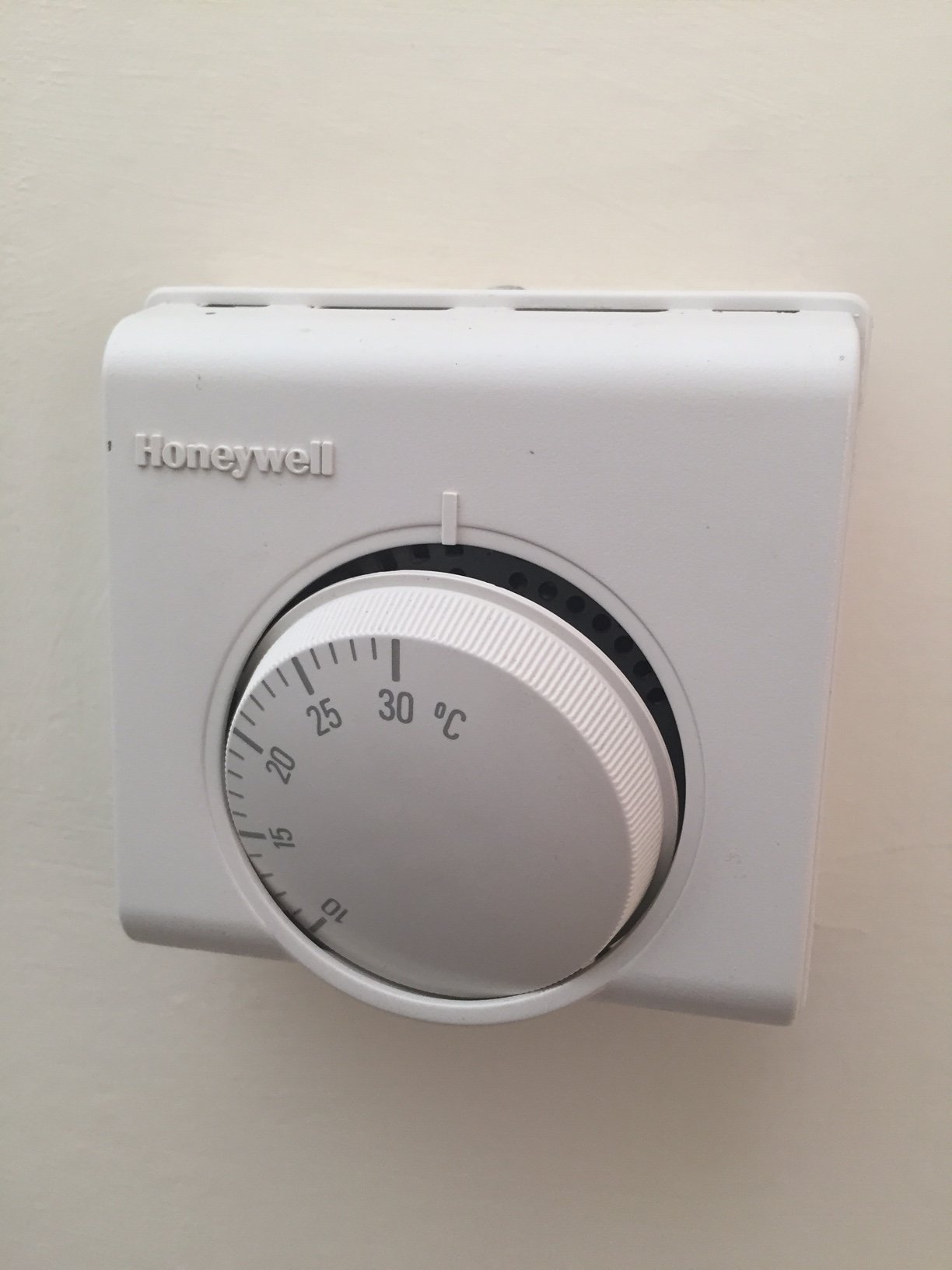

Am new to this forum so I am grateful for your advice. I have just bought a house (3 bedroom detached) which has an Ideal Mexico boiler in the celler area. There is a programmer attached to the wall nearby and a broken thermostat controller in the hallway. There appears to be a pump or something similar on the right hand side above the boiler.
In addition, there is a black water tank and a large cylinder in the loft space and another one of those pump things in a cupboard on the first floor. Plus lots and lots of piping.
I have been reading on here and so im assuming I have a vented low pressure system with an immersion heater in the loft?
At present I cant get it to work and heat the radiators although the actual boiler seems to be on and heating water as some of the pipes are warm. Its probably not working as the thermostat control appears to be broken. I have an engineer coming to look at it on friday.

I think some more photos may be needed, at the moment the roomstat looks knackered, that should be fairly easy to replace, and may account for the lack of central heating. However, the hot water is set to off, and without knowing the exact set up, (unsure what the 'other' pump is for), it is difficult to say what else may/may not be happening. I am confident it is a open vented system, by currently unsure as to if you have gravity hot water circuit/pumped central heating, fully pumped system, or something else.

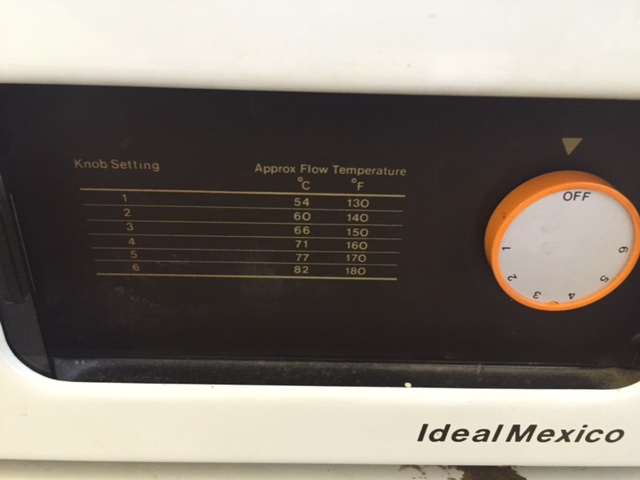

This is the control on the boiler

The boiler is set to OFF but the boiler still sounds like it is running and 2 of the radiators were ON and HOT today in the conservatory - all other radiators were cold. Also the dial on the cylinder in the loft appeared to be set at 70C but the cylinder felt cold although this may be due to the insulation round it.

Programmer is set to heating ON.....boiler stat is OFF.....radiators are getting warm due to 'robbing' the cylinder of hot water.....

Room stat is possibly calling for heat due to temp dial inoperative.
