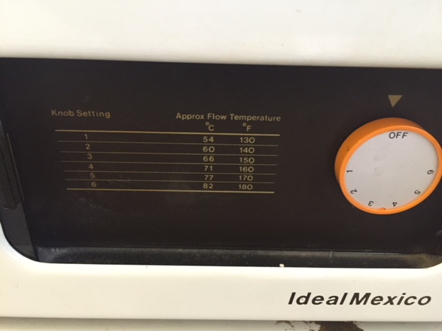

If i am setting the cylinder at 65C, does that mean my boiler setting always has to be at setting 3 or higher as anything less would be lower than 65C?

Depends what the stat settings on the boiler correspond to. I'd set the boiler a bit higher if need be, the water temp/room temp shouldn't get any hotter than setting on appropriate stat. I would also be looking to see the system has been dosed with inhibitor in the past to prevent it sludging up and premature failure of components.
It is advised to have hot water heated to 55-60 C.
Not 65 C !
The boiler temperature should be at least 10 C higher than the setting for the hot water temperature.
Tony
The HSE recommend "Hot water should be stored at 60 °C at least in order to kill legionella bacteria.", so I always set to 60-65 to be safe.
Not 65 C !
Tony
what the feck you on about? was always taught 65c was the temp on a cylinder stat, so by average it would reach a tap at say 60c through heat loss etc. please explain why not 65c.
