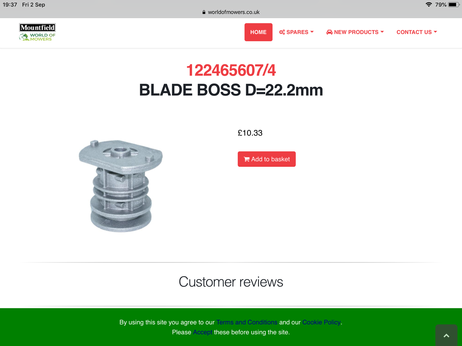

Looking at the blade boss the dowels look quite close to the edge for tapping, not much thickness either
For these, I either drill 5mm for a 6mm thread or 6.5mm for an 8mm one..... not exact tapping sizes I know but near enough.
I’ve never had a boss failure afterwards - there is enough material.
John
The cast knobs are around 10mm diameter so there is enough space, but I admit it’s a little tight.
I only do this when the user is forever breaking them off.....a couple a week on average!
The repair is strong - maybe too strong as the next failure splits the boss lengthwise.
