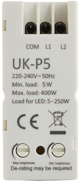

Those dimmers aren’t really suitable for LEDs
Prior to the extension, we had 50W halogen bulbs, which were on a dimmer switch. When the electrician replaced all the fittings with LED he also had to replace the dimmers, so they would be compatible with the LED downlights. I have to assume he knew what he was doing and as we haven't had an issue with the dimmers for 10 years they appear to have been compatible.
Why are you saying the dimmers aren't suitable for LED's?
1733593327485.pngGoogle shows this, minimum wattage 5 watt, maximum wattage 250 watt LED and 400 watt halogen so they should work with 2 or more LED bulbs as linked to.

Look at the minimum load on the dimmers
If 250W is the minimum load, I have no idea why they have worked so well all these years!
They were purchased from TLC Direct and I even have the model number, but after 10 years I can't find that particular product, which is not surprising.
I see the range of dimmer modules on TLC Direct tend to have very low starting values, even 0W.

Thanks for the info.
I'll wait until I get the bulbs I actually ordered, the ones that Megaman say are a direct replacement for the 10 year old bulbs and see if they cause the same issue. If so, I'll either replace the dimmer modules or even get rid of them.

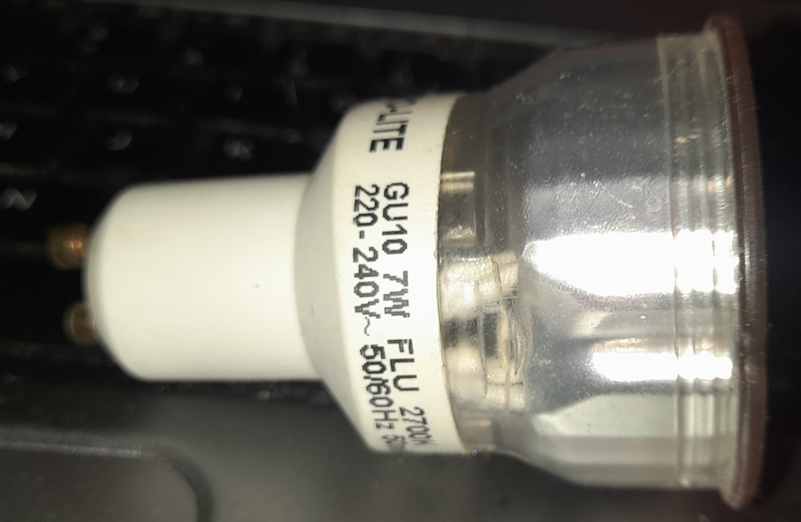

To be frank, 10 years ago LED's were only just hitting the market place, I seem to remember changing from compact fluorescent lamps (CFL) to LED about that time, and the 1733597142050.png GU10 before the LED would not dim, and was longer than the old quartz version and stuck out like a sore thumb.
I had by this time removed all my dimming switches as they would not work with CFL's, and we were looking at following how it was done in warmer climbs, and splitting the lighting into groups, a 1/3 and 2/3 split allowed three levels of lighting without dimming.

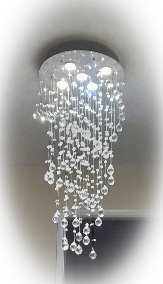

But to move from tungsten to LED in the living room, at the time we could not find a BA22d bulb in LED which can replace the 150 watt tungsten and shine most of the light at the ceiling so it is spread through the room, so it was replaced with a chandelier, so bulbs now do face up, and I can have 48 watt of LED lighting, however the chandelier was over £100 Ceiling light.jpg so to save 100 watt for say 6 hours a day, at 31.31p per kWh will take a couple of years, and if I consider the cabinet lights and uplighter we are actually using more today on living room lights to what was used when we moved in 5 years ago.
