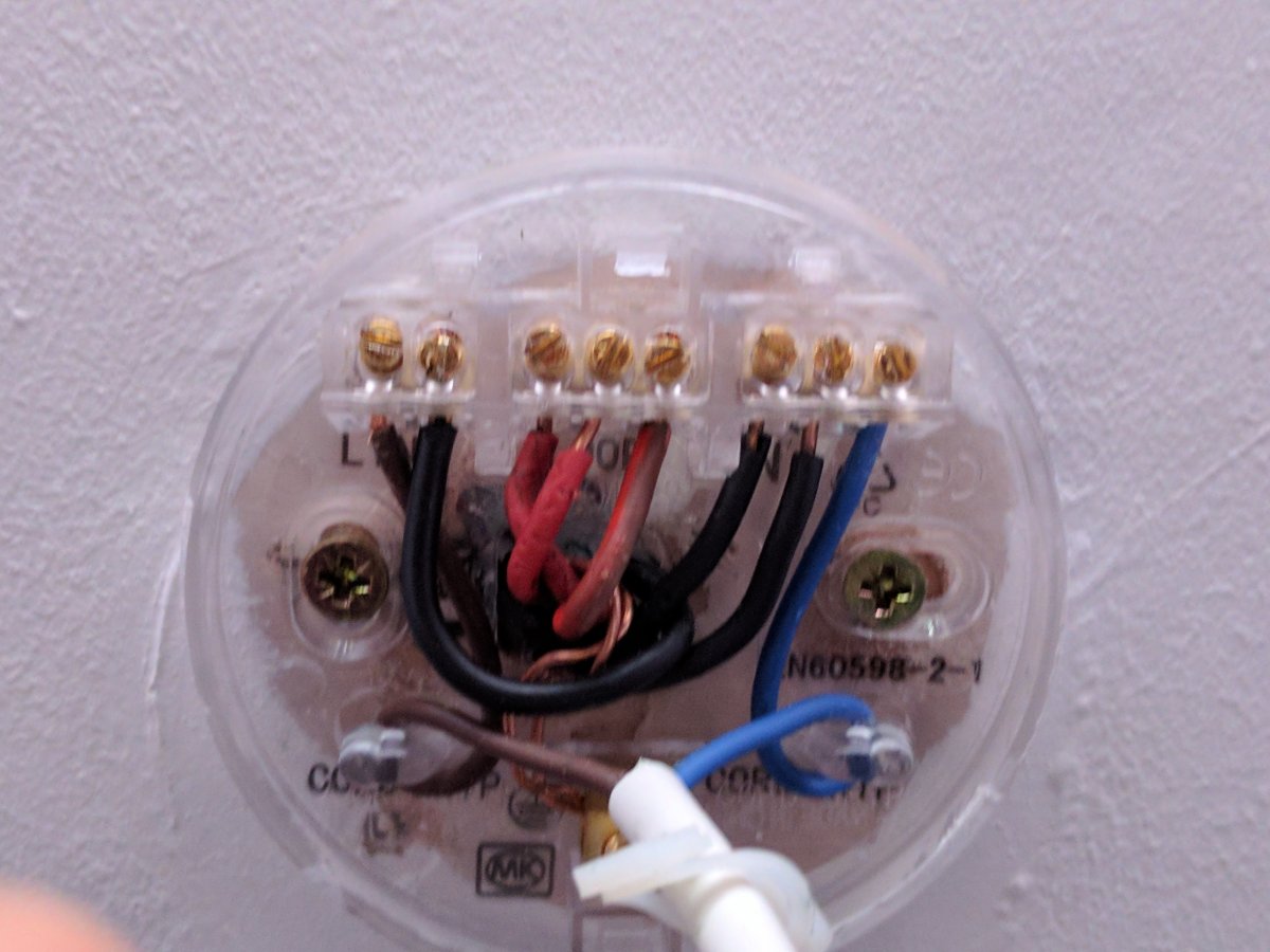

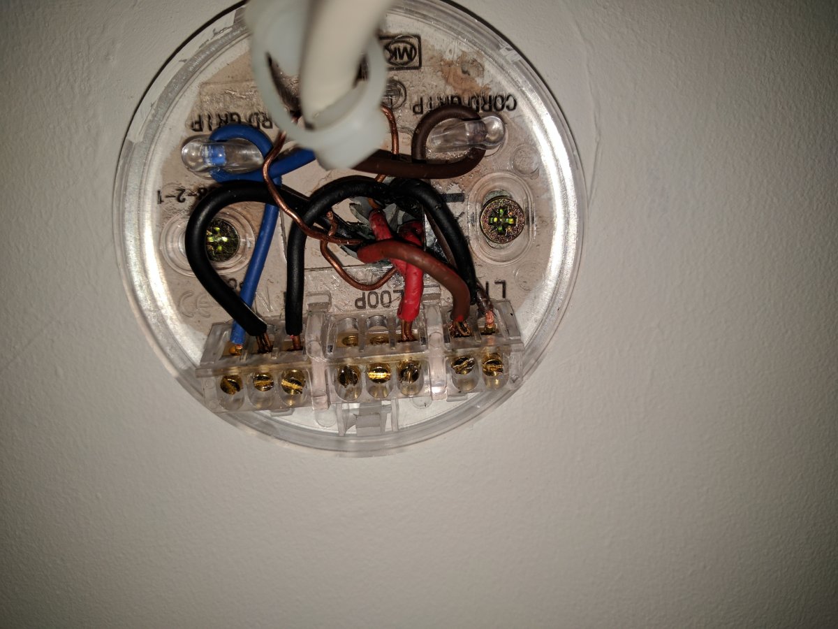

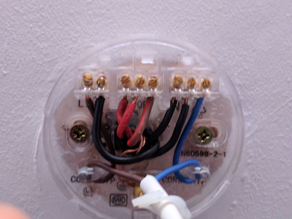

Hi,
First post, apologies for any missing info. I am in a bit of a pickle, having thought replacing 2 ceiling light fittings in the main bedroom on Christmas eve was a good idea, the pregnant girlfriend has run out of patience.
The room contains 2 ceiling lights, the issue appears to be related to the wiring of 1 fitting which contains 3 cables, image named 'not_working' that has been uploaded. I have spoken to an electrician who is unable to come out this week and done some research to ensure wiring is correct.
not_working.jpg: Live wires all connected to 'LOOP'. 2 Neutral wires connected to 'NEUTRAL'. 1 Neutral wire off the switch cable connected to 'LINE'. The 2g light switch has a live wire connected to 'COM' and a neutral wire connected to 'L1'. The upstairs light circuit trips, there is no light bulb in and it doesn't seem to matter if the light switch is on or off.

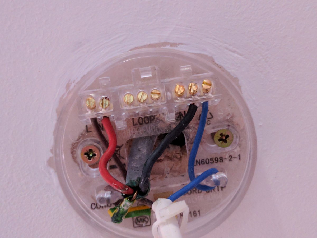

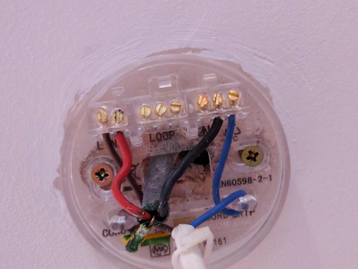

The other light fitting, image named 'working' was working fine with the new light fitting before I touched the second.

Presumably it was all working fine before you fiddled with it, which meant it must originally have been wired correctly? And when you changed it, you didn't replace the conductors where they had been when it was OK?
How do you know that they are all live?
How do you know that they are all neutral. With lighting circuits you cannot rely on colours, as not all black wires will be neutral.
For example:
If it's coming from a switch it will be live, not neutral.
How do you know it is the black from the switch?
Let's hope it doesn't, or when you close the switch you will be connecting L & N together.
What's connected to the other gang of the switch? Are there any link wires between one gang and the other?
What happens if you disconnect all the wires from the rose?
Do you have a multimeter?

Re-check with a multimeter which are the neutrals and which the switched line.
Also, if the light with 1 cable feeding it comes on with the other light, one of those reds should be in the switched line terminal.
The only possible short I can see there (assuming all the conductors are marked correctly) is that the switched line from the switch is connected to a neutral. But then the short would disappear with the switch open (unless the mechanism is welded shut).

I believed the single cable light fitting is being fed by the other... I thought this might be the issue.
Edit:
I understand what you mean, I have done this, thank you. Now the fuse is not tripping however the lights remain on, the light switch does nothing.

FYI, the current configuration has enabled the lights to work (no tripping) however the lightswitch is not working (cannot turn the lights off).
Well, that was going to be my question.
I guess that you have two lights in the one room controled by one light switch?
If so, one of the reds in the loop in first photo is in the wrong place and should be in the switched live terminal (marked L) on the left.
That will explain why that light is on all of the time.
You'll need a multimeter to discover what is really happening though.
The earth wires should have green/yellow sleeving on them and why are there only two in the first picture?

I pulled the sleeves off because one of the 3 earth cables broke so I wrapped it around the other 2, hence why it looks like only 2 earths. I realise this is not ideal :(
So frustrating, I have tried many combinations but obviously just guessing without a meter.

It looks like the wiring you have should now operate, though you may have the polarity wrong, this need to be proved with a meter. I expect the switch has been damaged by the incorrect wiring and is now stuck on and will need to be replaced. Wash your hands after handling the wires, the green stuff should not be ingested.
