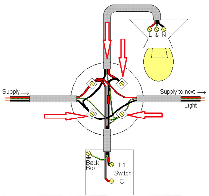

Hi
I will explain what have done so far . I have installed 2 new led lights in the garage to go alongside the original batten already in there . There is a switch either side of the garage for the original light obviously a 2 way configuration however I connected my new lights to the existing switch BUT the existing switch has red blue and yellow , I have red black and earth so I did re/red, blue/black, and earth to yellow they work but are on when the switch is off and off when the switch is on and the original light also works in reverse order! I have looked at a wiring diagram on the site but just cant get my head round it . I would like to use the "spare" switch but obviously need to to add some internal wires but not sure from where to where ie com, l1 l2 etc . Could someone just explain in simple terms which wires go where also you will notice form the pictures that the original earth wire is not connected to anything , maybe this has something to do with it being a two way switch? If someone can help it would be much appreciated . I have put extra sockets in etc but that was straight forward red/red ,black/black and earth to earth no problem its the yellow that has foiled me (i think) If you want to know anything else please ask I have enclosed some pictures for what I hope is clarity.

Likely red, yellow and blue are all line wires, bare copper likely earth.
There are two ways to wire a two way switch, but this is the most common.
The wire colours can be brown, black, grey, red, yellow, or blue, it is just that people use cable with three phase colours, in theory they should all have sleeves to show if line or neutral but often they don't.
So often the only place you can get both line and neutral is the light, often there is no neutral at the switch.
Green was the colour for earth, but this was changed to green/yellow, but yellow has always been a phase colour.

Ok, but it doesn't matter how complicated it looks,
you just connect the new light to the same terminals as the old light
and ignore all the other terminals.
Hi Impudance,
Thank you for the detailed drawing but do I see a black wire in the same terminal as a red? that is the bit that confuses me lol. I have the same problem with a new security light I fitted it works fine but the other one stays on and yes there were 2 sets of wires coming out of the wall (at least they were red , black and earth) but someone suggested I put one of the blacks in with a red that's when I stopped lol. like I mentioned before I taken spurs off existing sockets no problem but this project beat me so I resorted to fitting a plug and just switch them on when required . I dont like being beat but sometimes you have to give in gracefully lol
