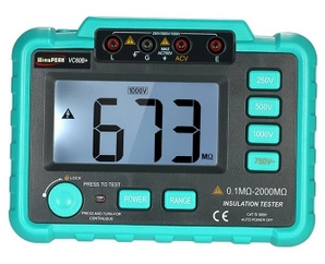

Earth to neutral leakage is normally found using a insulation tester VC60B.jpgthese are also often built into PAT testers, but can't be found using a multi meter most of the time, a clamp on ammeter Clamp-meter-small.jpg may help, but either way hard for the non electrician to find the fault. I have all RCBO's which is a RCD and MCB combined so if some thing goes wrong, I don't loose as much, and earth - neutral faults are less likely to cause tripping.
So for you first thing is to unplug anything not in use, a bit of damp bread stuck in a toaster can cause the RCD to trip when kettle is used, if the toaster is left plugged in, as the switch on the toaster only switches the line, it does not switch neutral, so to switch neutral only way is to unplug.
For me it is easy, I have the testers and knowledge how to use them, but for you only thing I can suggest is unplug all items when not in use. Items which are double insulated are less likely to be a problem, one often they are double pole switched, and two no earth to leak to, but I really have never considered how to test for earth - neutral leakage without my meters, as never needed to do it.

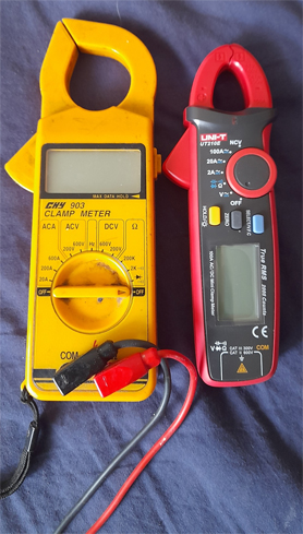

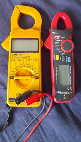

Do you really think that clamping round N&L will show EARTH leakage?
Yes my house shows around 26 mA total, but that is shared between 14 RCBO's so no problem. However of the two clamp on meters shown, the yellow one only shows down to 10 mA increments so really not suitable for finding earth leakage, the red one do measure down to 1 mA increments, and is OK with AC, but on the DC scale testing for the 6 mA DC leakage not really much good as needs zeroing then not moved, and can't really do that over meter tails, so still a bit hit and miss with DC.
But the problem is most DIY people don't have either a clamp on or a insulation tester, even the cheapest are £35 each, and if bought then they still need to learn how to use them. I have needed to use PMR 466 two way radios to get a helper to turn items on/off in the past while watching the meter in the past, so easier with plug in stuff to use the insulation tester. I can do that on my own.
Again as electricians we know mineral insulated stuff is most likely the cause, so heating elements, kettle, immersion heater, washing machine, frost free freezer etc. The latter is a problem as only when in the defrost cycle, so testing neutral to earth is only way, and hope not double pole switched.

A insulation tester cheapest I could find cost me £35, and you need one to test further. Easy enough to use, clip one lead to earth pin on plug and other to neutral pin, set to 250 volt and press button. One is looking for a reading over 1000000 ohms or one meg ohm.
But if you get some one in, maybe not only find the fault but can cure the fault.
Likely the problem is the mineral insulated heating element in an appliance. But really need to test, not change to see if that works.

Managed to get my hands on this today. He has this one https://amzn.eu/d/aFeNWvs
Not had much chance yet, but checked a few appliances. Plugged the lead into the E and L sockets and clipped to Earth and Neutral pins. Pressed the button and bar a very brief random number showing it then sticks on 1 MOhm.
Assuming ive done it right, does that mean those appliances are fine?
What would a faulty one show?
Testing neutral to earth is the main thing, as tripping with nothing turned on, and 1MΩ is a pass would would expect higher.
Ok thanks. Guess ill spend a bit of time tomorrow testing a few other plug in appliances and see if anything jumps out
