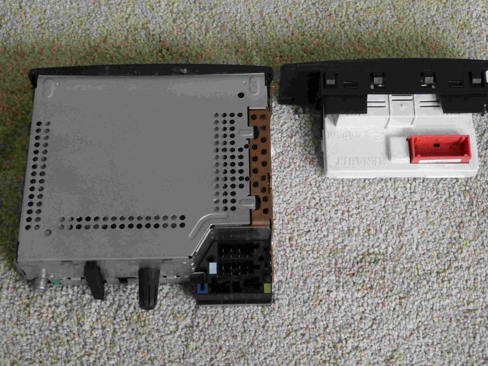

see on the red connector are some connetions, that hopefully will be in the new 8 pin sockets.
From what I see (if the image I posted was representative), the red (20 pin connector) has connections for CD and line out.
Why do you need anything at all from that connector, for your new cheap FM Radio?
You appear to have two standard Iso plugs, (black and white) thhw should plug straight into your new stereo and it should work, the old change that may need to be made is to the red and yellow wires that control the permenant and switched lives, they change between manufacturers.
Don't cut the aeriel cable, the correct adaptors are pennies and just push on.
From what I see, the red (20 pin connector) has connections for CD and line out.

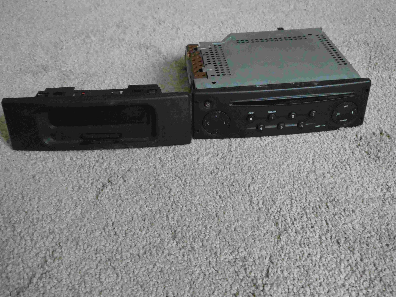

Is the radio in the above picture the old one or the new one?
Were all of those connectors attached to the old radio?
If it's the new radio:
Can you post a picture of the old radio with the connector blocks attached and one of the old radio with the same connector blocks disconnected?
If it's the old radio, please post a picture of the new one?
Hi S,
The radio in #1 is the new radio with 2x sockets, plus antenna, plus phono sockets.
Here's the old radio/cd:
C

Now I've looked at the new radio connections andcompared them with the diagram #14, and they are straight forward Red+ Blk- Blu for a power antenna (not got) and yell for memory??
There are 4x speaker outs, I need only 2x and they are paired wires.
I need an antenna adaptor.
Does the memory wire need permanent power?
C
Yep, a permanently live +12v - it's to maintain the channel frequency memories, when you switch the ignition off.
