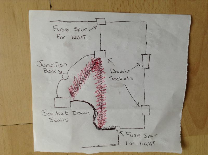

Hi all looks like this has turned into a bitching match .
Just to confirm that I messed the picture up and that ban all sheds is right what he has been saying.
The job has been done and is all working fine with two lights running of F.s.
This is the way it was done.
The red bit was my mistake.
The socket I went from had 3 live 3n and 3 earth wires in but when tested two where live 1 was dead.
So one live was put in J.B and ringed back to socket .
Assuming that those two 'lose ends' are connected into the rest of the ring, then it's still wrong - what electricians call a 'figure of 8' circuit, not a single ring.
Yes, it will work, but it's also 'wrong'.
Kind Regards, John

Are you just a Troll:::::::::
Where are the cables bringing the power into the downstairs socket?
Or does it just magically energise the rest of the circuit?
I am working on the basis that the loose ends are to the lights from the switch fused spur.
