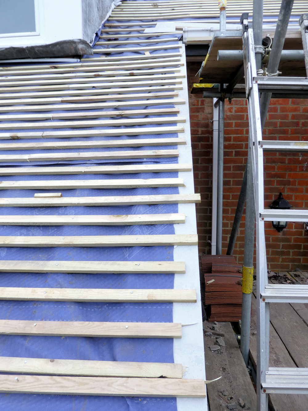

First one is the felt is over the under cloak, I did mention it to the roofer early on who insisted this was right. I've since seen info saying it should be the other way around??
Also I understand, now, that there should be not cut edges of battens in the mortar, or they should be treated, the ones in this shot are obviously cut. Treated? Not to my knowledge.

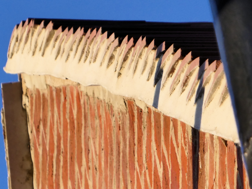

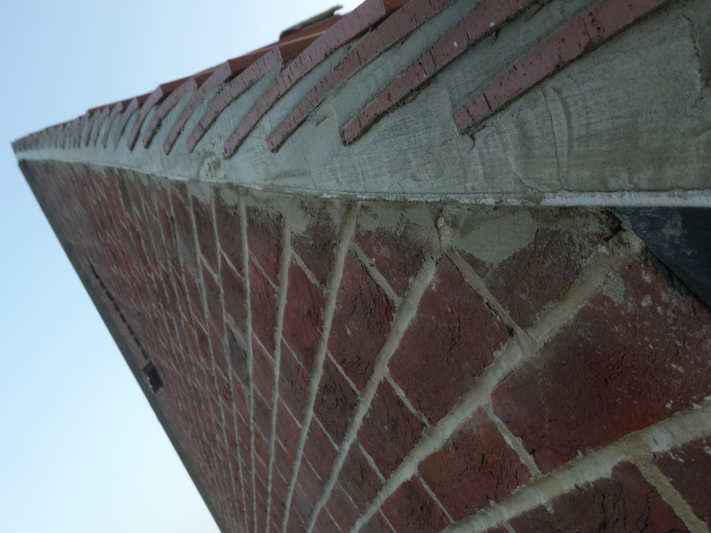

They have been cut back and the verge mortared but there are hairline cracks in the mortar already how much of a problem are these cracks? He says they're not important and don't go all the way through the mortar (x-ray vision is so useful).

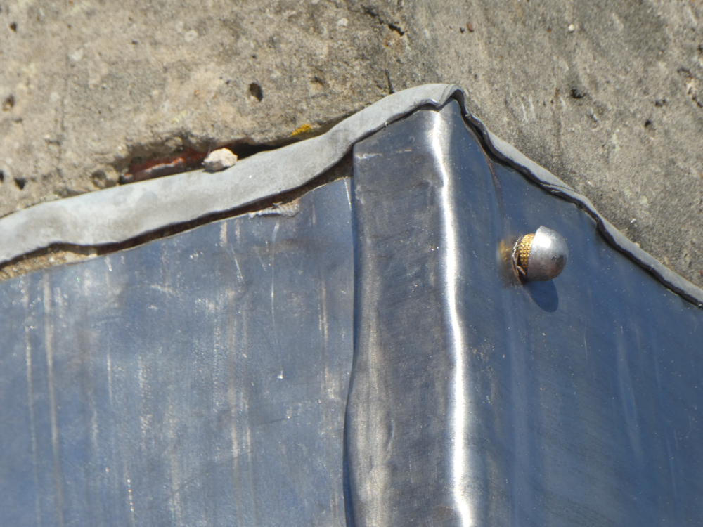

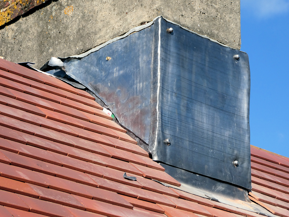

The chimney. Originally it was to be rendered. He reckoned the brickwork was too bad a condition to cut the soakers into it so was going to render down over them. I was concerned the render could fail and the water run down behind it and behind the soakers. So I asked about cladding the lower chimney in lead. 'Good idea' says he. Said he needs to get 900mm wide lead, then cuts it down to less than 600mm and the second and third images are the result.
I could have cried. Not with laughter, well not at first. What a waste of good materials. I have told him to quit with the lead, please just render the lower part of the stack fit the ridge tiles and go. I don't think he's capable of doing a decent job.

Got any images of the verge? It should not crack. He may have used the wrong mortar.
The chimney reminds me of an old German coastal gun emplacement. Are you on the coast, is the roofer German? :cautious: I can't see that lead being any use at all.

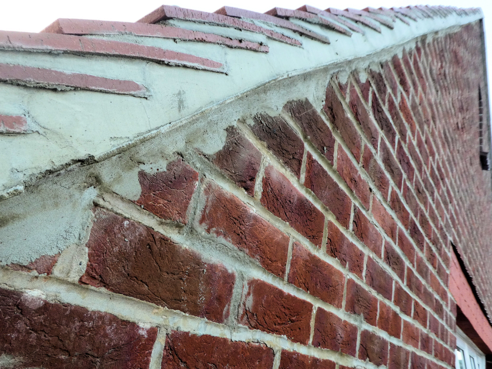

A couple of images of the verge below. The cracks are not so evident in these images but there are plenty of them elsewhere, I'll see if I can provide some better shots of the verge work later.

It all looks amateurish.
Tile gauge looks a drift ,
Batten size is below regulation now
Under cloak isn't correct,
Mortar work rubbish
Lead work Cr AP and will do nothing , probably blow off.
And they are plain tiles , not peg tiles
Mortar work rubbish
I agree, the mortar is absolute rubbish. It's up down and smeared onto the bricks underneath. Mine are the same - style that is. I did them with the help of the lad around 25 years ago, he was around 13 then. I decided the best way to make a tidy job of it, was to make up an angle iron frame about 2 foot in length to both rest on the tiles and fit below against the bricks. Starting at the lower edge, we pushed the mortar well in, let it go off a bit - long enough to be self supporting, then move the frame up a couple of foot, repeating until it was all done.

Datarebal that lead is NOT going to stay there. The wife, an office wallah all her working life, said she could do a better job. Not often she voices an opinion like that. Thing is she's right :)

Leadworks, properly fitted would be a better weather proof job than render in this situation .
