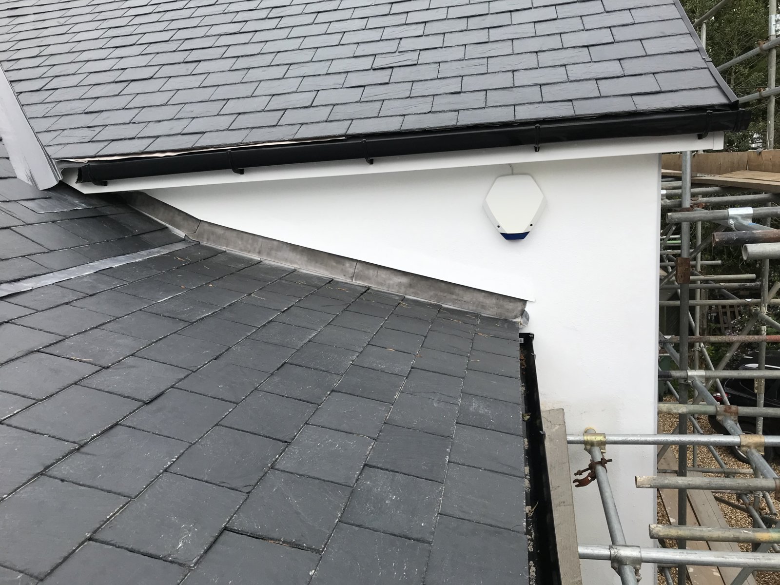

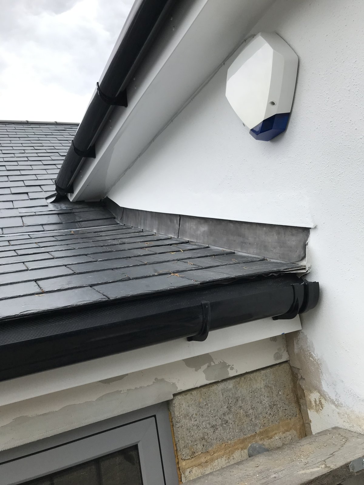

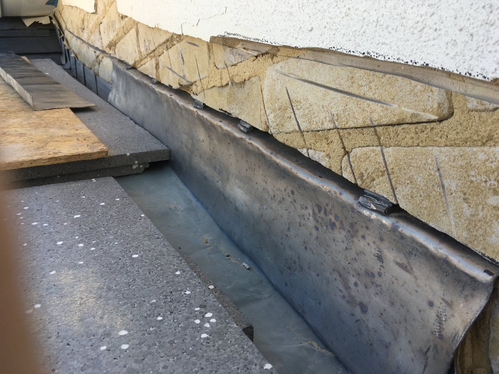

In case anyone is interested here is the finished product:
Plus some of the stages:

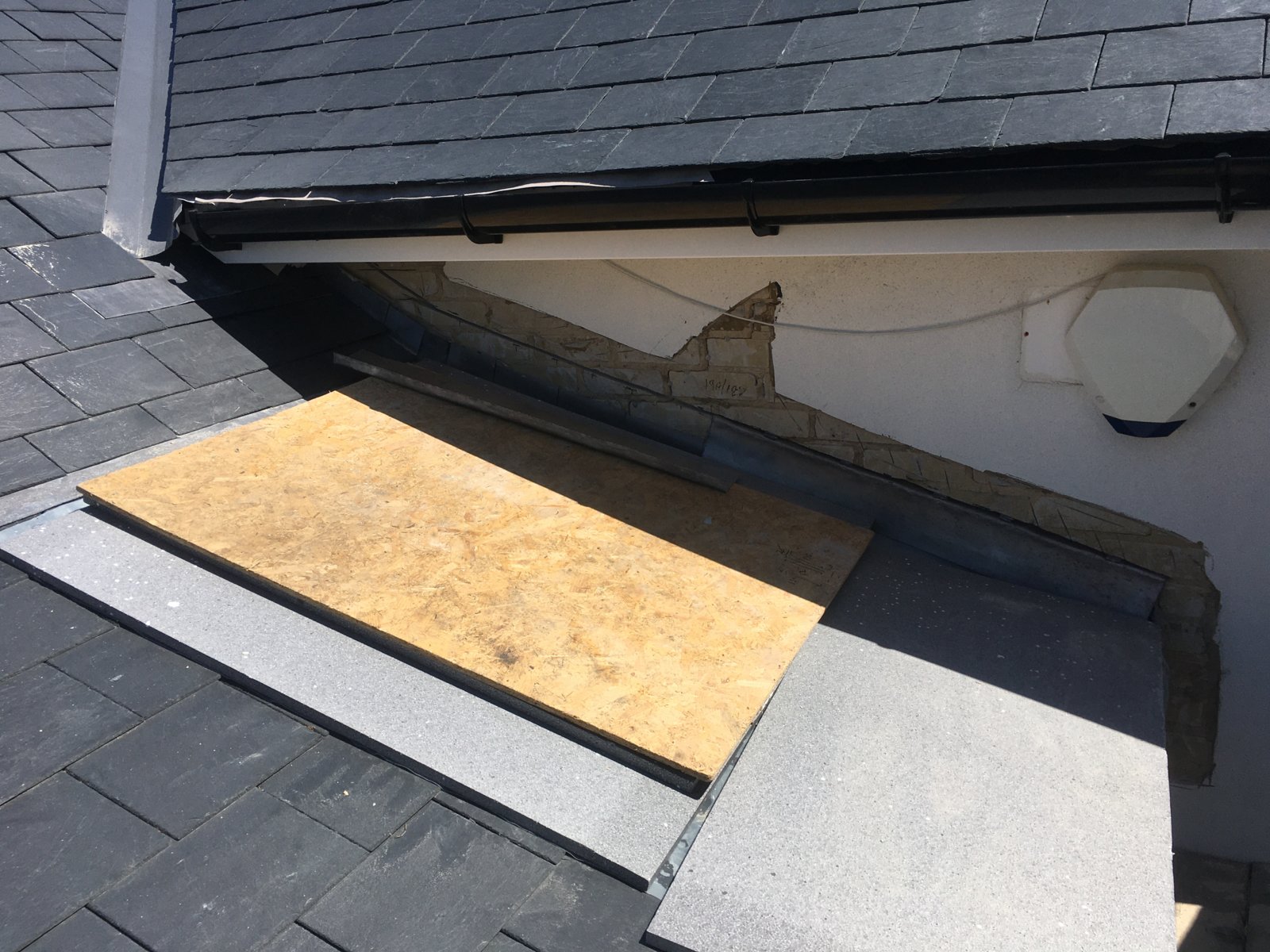

Lead going in:

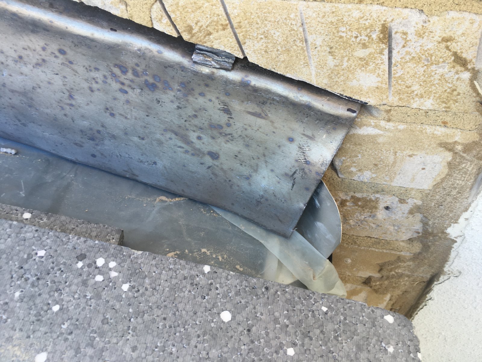

Kickout installed:

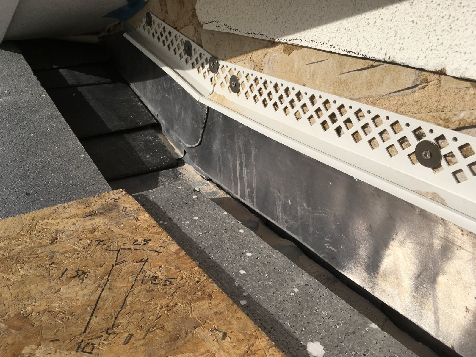

Bell bead plus stainless steel screws and washers. Bell bead is just above the lead!
Done:
Thanks for all the tips everyone!
