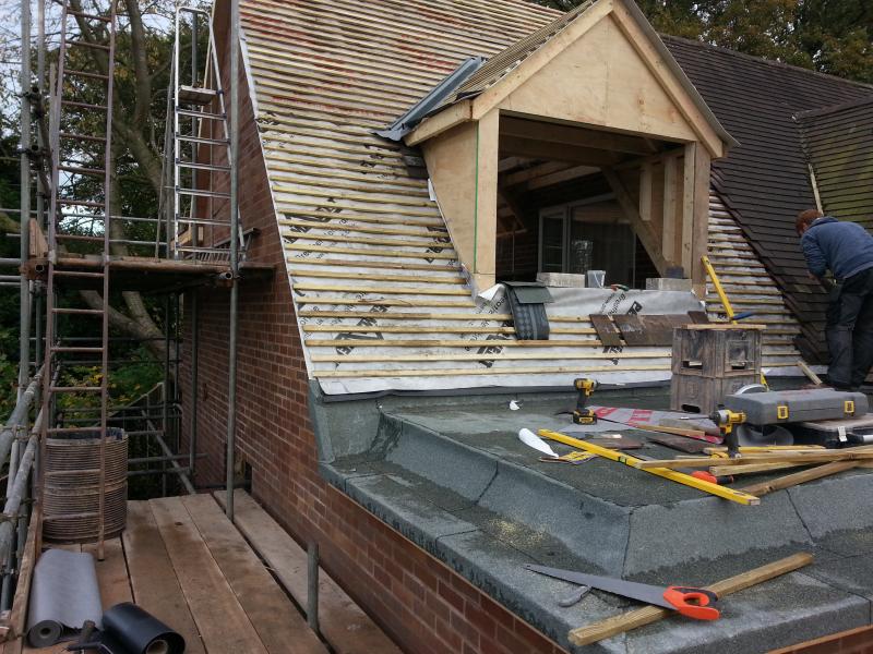

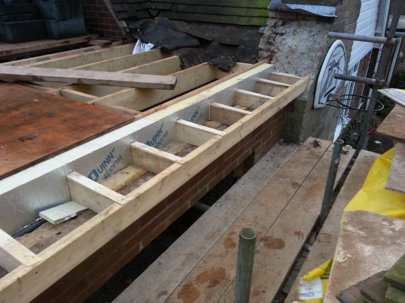

noseall posted an interesting thread or maybe added the photos to someones thread in the roofing section about achieving a thinner fascia for a warm room roof a few months back, might be worth looking.
thanks for the pics - tried to look through noseall's historic posts but there were too many!

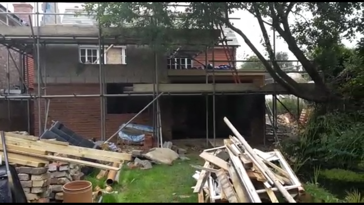

I attach a poor quality image of the back of the house below (flat roof on the right is the one in question). The rafters are 175mm and you can currently see currently the rafter on the end above the wall, the roof drains to the side. I'm thinking that we should continue to build it as a warm roof and lap the GRP 100mm down from the top , this would then leave circa 20cm of white painted wood visible on the back (which shouldn't look too thick).
Also, we were going to add down lighters above the bifold doors... just had a thought that we could introduce a horizontal strip of LED's in a diffuser between the bottom the GRP and the white fascia to "hide" the lights and make them a bit funky, could even get the multicolored ones ready for a party or two!
