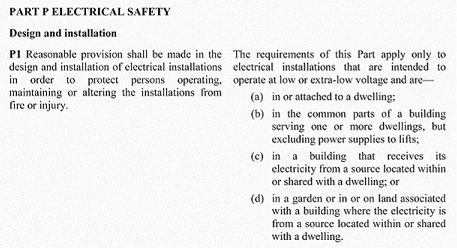

The TN-S supply can at any time be changed to TN-C-S so it is prudent to consider it as being TN-C-S even if it's not. So at some point the earth needs to change, the question is where.
Easy enough to use a plastic adaptable box at one end, this old IET Wiring matters does refer to using a TT from a TN system. The main point is
An exposed-conductive-part connected to one means of earthing must not be simultaneously accessible with an exposed-conductive-part connected to another means of earthing (Regulation 413-02-03 refers). Where the installation in the garage is supplied by an armoured cable, the armour or any protective conductor in the cable must not be connected to and must not be simultaneously-accessible with any exposed-conductive-parts in the outbuilding.
This seems to say the armourer is connected to the TN supply, and the gland must be isolated from the outbuilding, or in your case caravan hook-up point. I have seen a plastic stuffing gland used, and the SWA cut back at the hook-up end.
In the main, the fire regulations ensure the caravan is far enough away for donor building. As to if a farm is covered by Part P depends on where the DNO supply ends, the house could be supplied from farm buildings, so no Part P, or the farm buildings supplied from the house, but in the main supply to a farm is split or three-phase, and only one phase wanted for house, so likely house supplied from farm buildings.
As I said, not cut and dried, but it would seem prudent to use a scheme member just in case. I know where I work, it is also hard to work out, as, although it has accommodation, it is also railway premises, it gets complex, so many special rules.
A caravan is a dwelling, but does not come under Part P, OK very clear why, Part P is a building regulation, and a caravan is not a building, but simply being a dwelling does not mean Part P applies.
Is it not fairly clear?
Whilst Part P (of the Building Regulations) says that it only applies to dwellings, it does not say that it applies to all dwellings.
"Part P" is "Part P of The Building Regulations", which only apply to "Buildings", which the Regulations define ad ....
“building” .... means any permanent or temporary building but not any other kind of structure or erection ....
It is surely apparent that a caravan is not a 'building' but, rather, is "another kind of structure or erection" - so not within the scope of The Building Regulations.
If caravans are not within the scope of The Building Regulations, then it's surely the case that neither Part P nor any other Part of the Building Regulations can apply to caravans, isn't it?
Are there not Regulations,, or pieces of legislation, relating to caravans and, if there are, do they contain any requirements in relation to the electrical installations within caravans?
If it is a dwelling, then...
Is there a dwelling?
As I've just written in response to eric, even if it is a "dwelling" (in the everyday sense, given that the Building Regs do not define it), it would seem that it will not be within the scope of Part P (or any other part opf the Building Regs) if it is not a "building'.
In my humble opinion any electrical supply that is shared with a dwelling comes under Part P , the obvious example is the flat above the pub or shop makes the whole pub or shop come under Part P as well.
I would expect the caravan to do so similarly .
That’s the way I would be inclined to treat it.
