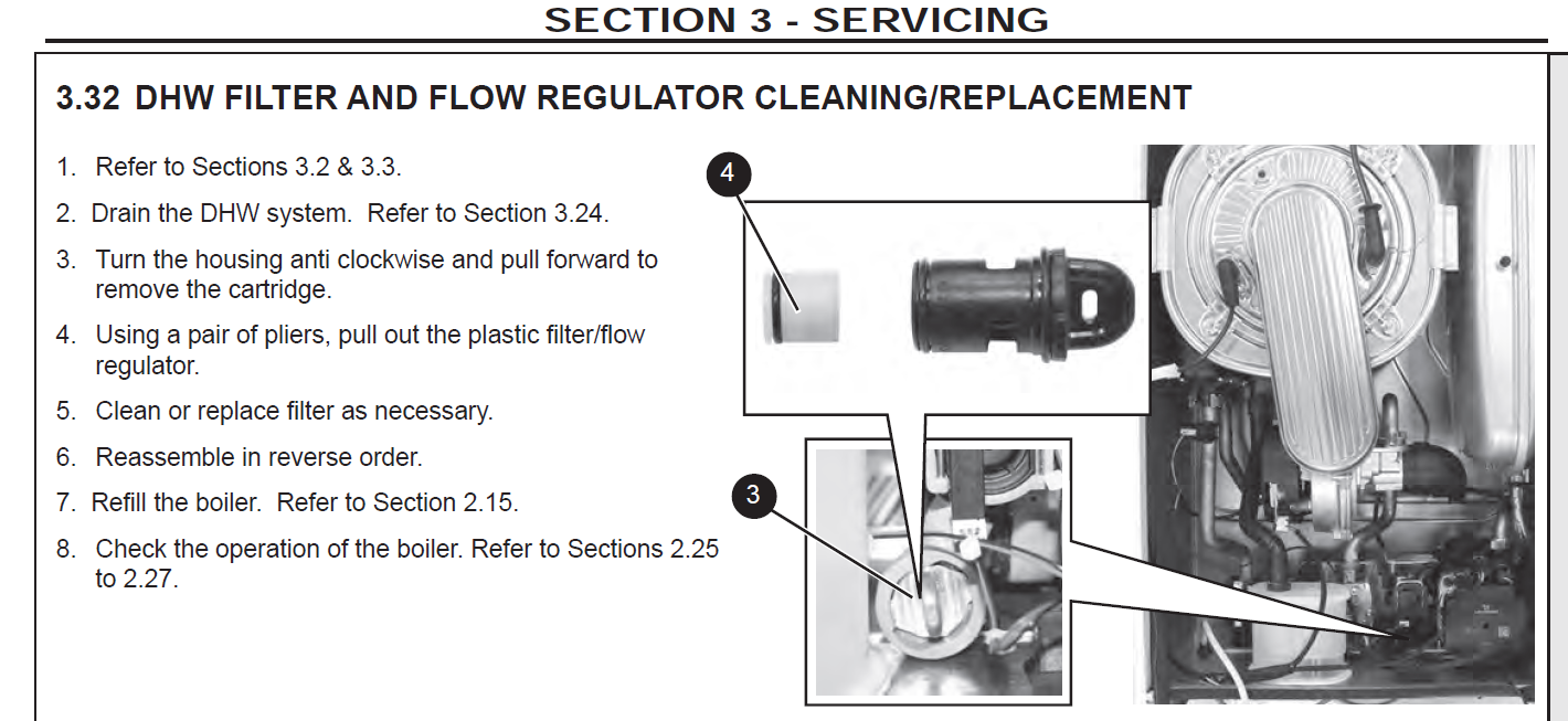

Maybe worth reading my post #15 again. Surely it's not too much to expect a 40kw combi boiler to deliver a flowrate at least as low as say 5LPM at 40/45C?.
It doesn't mention a DHW thermistor (sensor) in the manual so possibly a derived DHW temperature even though its settable and may be more sensitive to low flow/high temperature, also, may be worth cleaning the DHW filter which should also be carried out with a boiler service.
