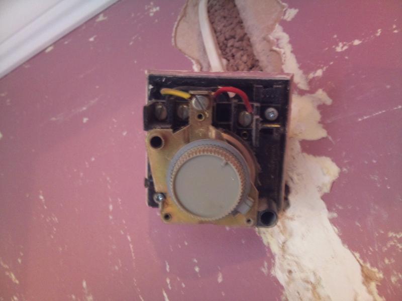

Hi,
I'm trying to fit a new thermostat but it wont work. This is the third one I've tried but they either work at random or as this latest one is doing the heating constantly stays on even when it's turned down to the minimum temp. It is a Honeywell DT90e thermostat with a Potterton EP4001 timer switch and a Baxi Solo 70PF boiler. The wires at the thermostat are L (red) N (black) and earth. Please help, driving me nuts.[/img]

red live from programmer
black sw/l to mot valve.
when the stat is turned down below room temp does the black have any voltage reading ?

I'm not really clued up on all that stuff and dont have the gear. It was just that the old thermostat had seen better days and thought I'd change it when we redecorated. I assumed it would be a straight swap. I first bought a digital one that didnt work, then I swapped it for a Honeywell manual dial type which had pretty much the same terminals as the original one (1,2,3,4 and Earth) but that didnt seem to work the heating properly. I then read that the DT90e was a straight swap for a three wire thermostat so I bought that but the heating just runs buy the timer switch now and ignores the thermostat.
you've wired it ok.
does the heating cut out if programmer heating turned to off ?
does the heating cut off if you push and hold the on/off button on the stat ?
Boiler comes on and off with the timer switch but if I put the programmer to constant and then turn the thermostat on and off or up and down it has no effect on the boiler. It just keeps going.
does the little flame on the stat go out when you lower temp and boiler stays on ?
No, the boiler keeps running. The flame on the display comes on and off when it is turned on and off or up and down and you can hear the click in the stat when you turn the temp past the room temp.
need to check with a multi meter really to see if the black is always powered.
or take the black out of terminal. heating shouldn't come on.
The stat also displays the flame and clicks when turned up evne when the boiler is set to off on the programmer. Am I right in thinking that if the boiler is on constant it will run as long as the room temp is lower than the temp set on the stat and it will go off when it rises above it. So if I turn the temp up and down I should hear the boiler switching on and off?
yes
So why did it work with the old stat but not with the other 3 I have tried. I haven't changed any wiring in the programmer. Thats whats baffling me!
