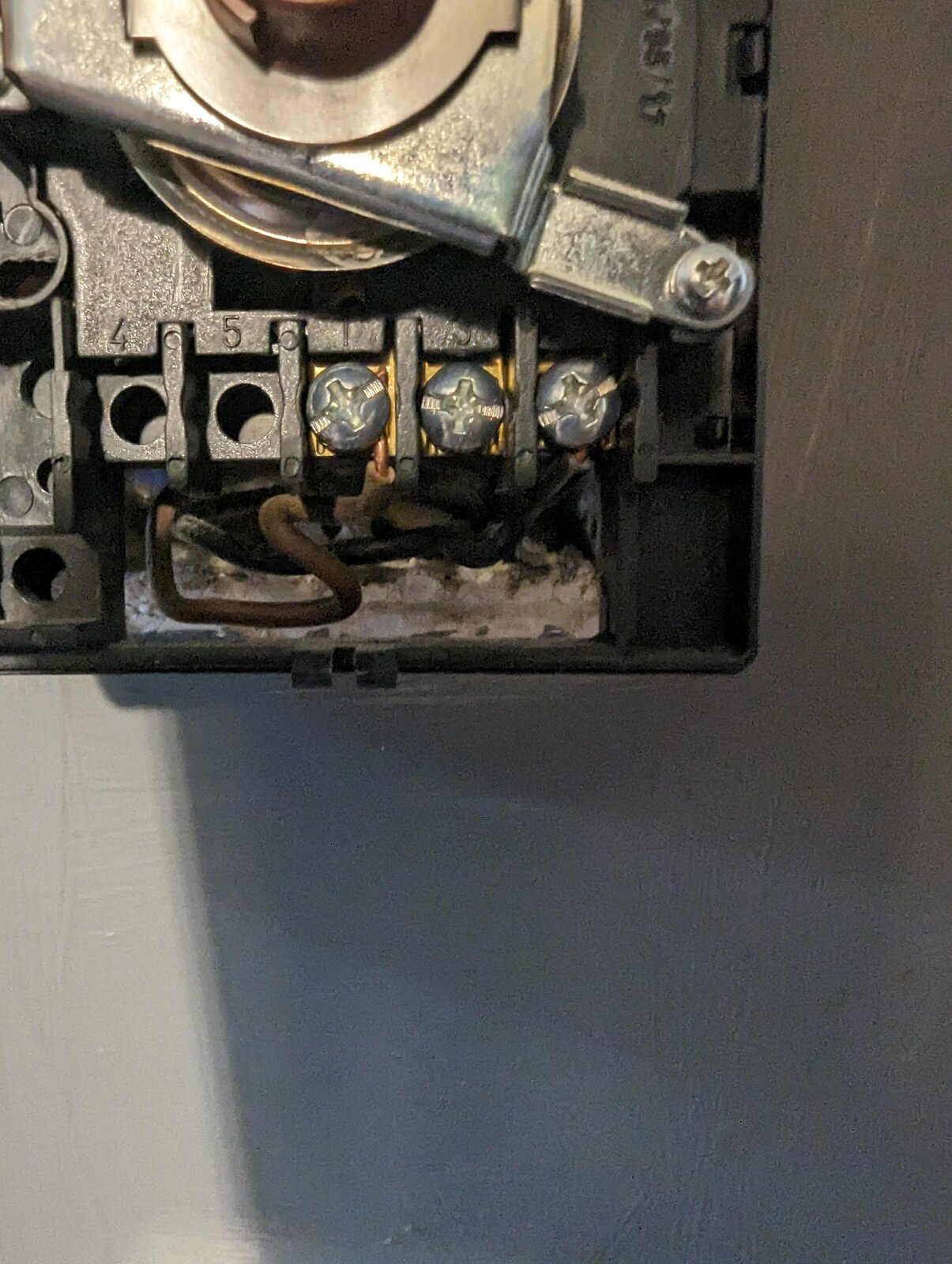

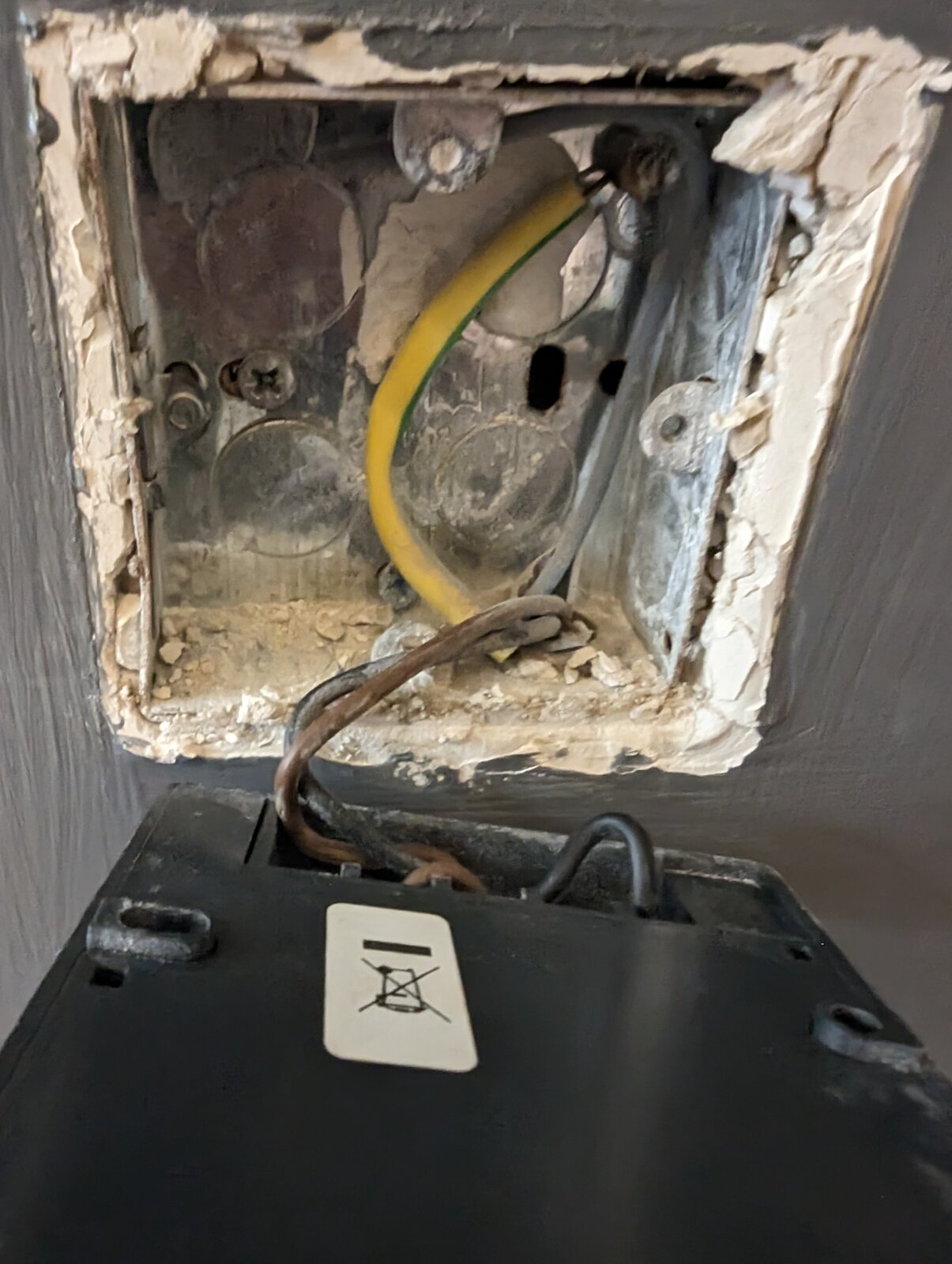

hi there I have this old thermostat it has a black an brown wire connected with a earth an grey wire not used I'm looking at a new smart thermostat but to my understanding I need constant power would I get this from current set up

The earth is only connected to the metal back box, not the thermostat. The grey could be a neutral wire. Plenty of options to choose from as per @RandomGrinch a Nest E could be used, as could any other battery operated thermostat. If the grey is neutral then other thermostats could be used, and depending on your setup/boiler then there are other options too.
What “smart” thermostat were you considering?

So yes, looking at the wiring diagram it needs a permanent live and permanent neutral, depending on your boiler/setup one of those wires might be permanent live, and if you can test the grey, that might be a permanent neutral, so in essence it’s a possibility.

i have tried to test the wires but getting nothing from black or grey no voltage at all so i dont no if im doing it wrong or not

The grey would need to be connected the other end. Black is possibly the switch live. Test between the brown and earth and then switch the thermostat to the in position and test the black.

I have tried to test the wires but seem to get nothing at all an tried to put thermostat at different positions and get nowt
