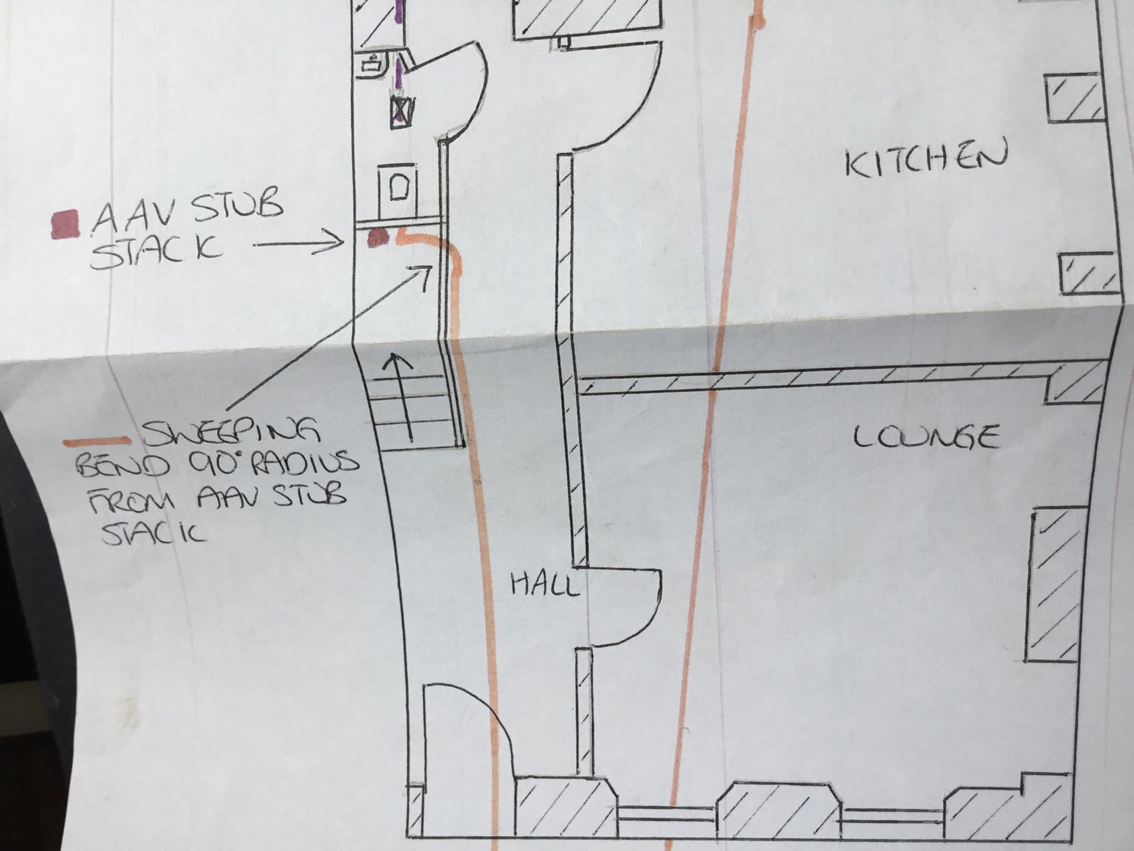

I am wondering if it is possible to install a toilet and sink under my stairs/ in the alcove. Here is a picture of my house from when i added an extension 5 years ago. The long/short dotted line going down the plan is my main drain pipe that was originally encased in concrete before the extension.
I think it is still in concrete, it was a hump under the suspended floor about 30cm wide and 30cm high.
Do you think it would be possible to join onto the waste? View media item 91144 [/img]

Thanks. I have since found out the gap to get into the under the kitchen floor where the large hump of concrete is too small to get through.
Would it be possible to run a new waste pipe straight down the hall and under the front door? I know there is a waste drain cover approx 5/6 ft away from the front door step.
I don't think the plans would be an issue, I could copy and upcycle the drawing that were used for the extension. The photo that is attached is part of the plan that was provided to my local planners and building control. ( I am not in the UK) and the 2 story extension was passed :)

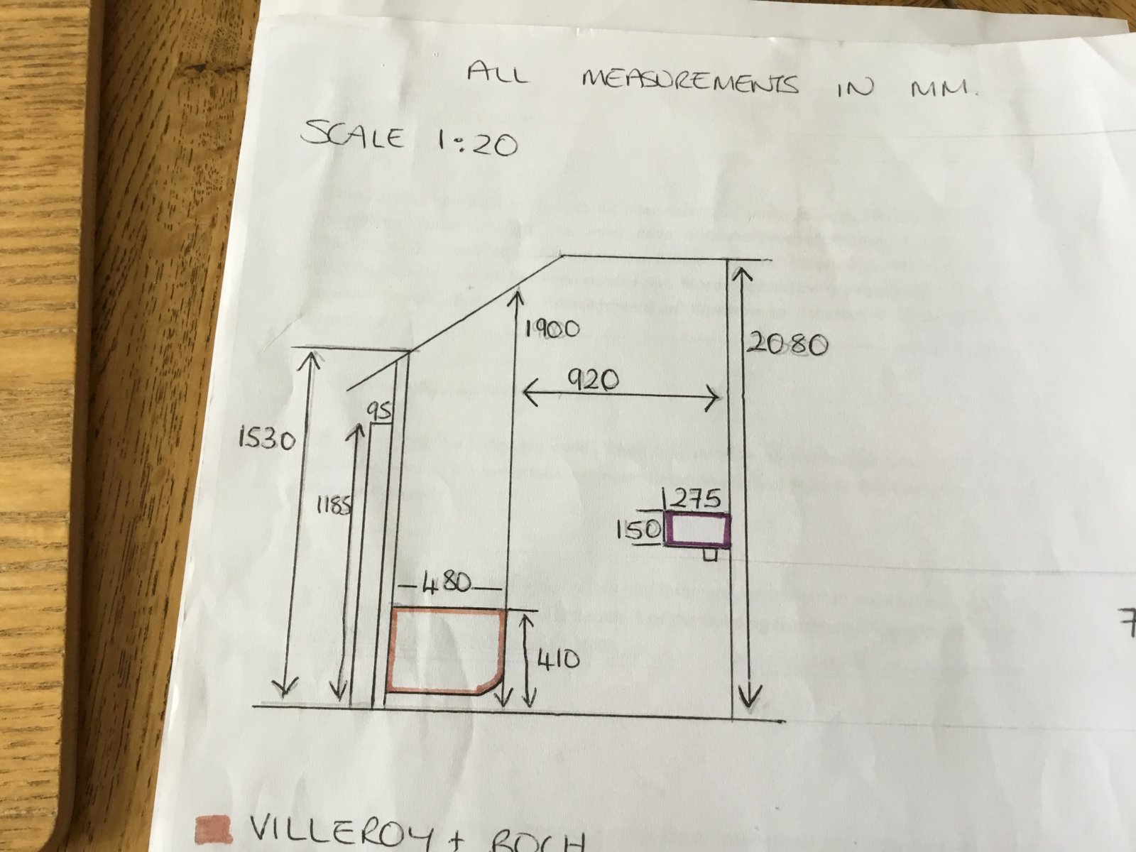

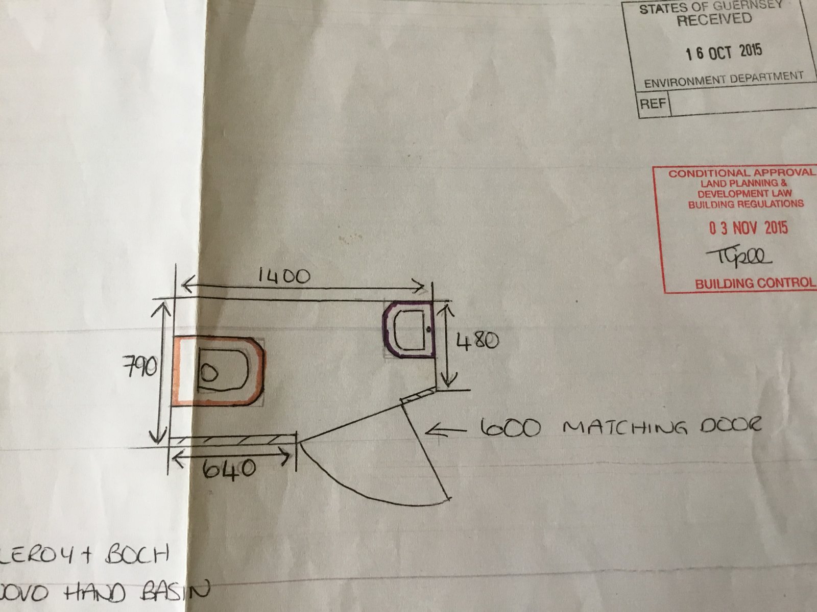

IMG_0186.JPG IMG_0187.JPG IMG_0188.JPG I have the planning permission for my cloakroom and the builder has been and fitted the waste pipe, inspection chamber and connected to the manhole in the drive.
I am trying to work out how the basin waste will link up to the wc waste. Can the basin waste run down the wall, in a pipe of course, under the floor and then link up to the wc waste under the floor?
Here is the plans, the basin is opposite the wc. I have a wall mounted wc.
