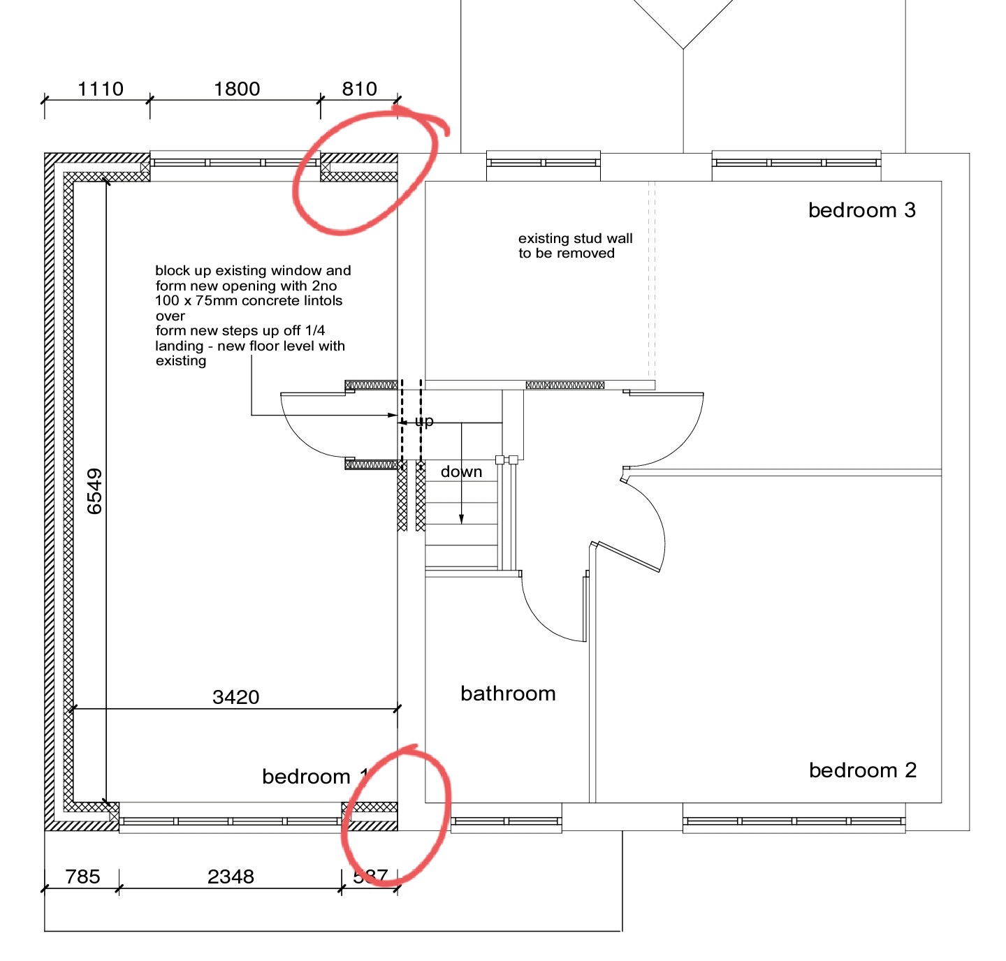

I'm having a 2 storey side extension. Where the new walls meet the existing corner of the house, is this an acceptable way to join the two together......
If it is, what width would the vertical cut normally be and is there a particular product that is used as an insulated dpc? The new walls are block, the existing are brick. The exterior is being rendered.
That pic was from LABC website..... I wasn't sure (for the reason u just gave), hence me asking here. I've never done one before, so was just trying to find out what's acceptable
Once did it on a porch, and just ground a 50mm slot in the house wall.... it worked fine, but no building inspector
Normally, you'd just run the disc saw up the wall and slide some DPC in and either wedge it with folded dpc or a bit of mastic. No need for insulated dpc.
But in reality most people don't bother, and the chance of moisture moving over 300mm sideways to reach the new inner wall is nil.
I asked my BC about this as my DIY books said I need to do it.. BC said no need for any cut or anything ..
