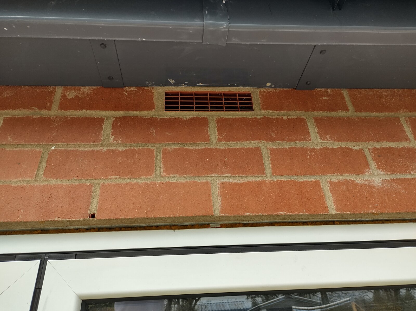

The other difficulty is that 8,000mm2 is a big area for trickle vents- I've fitted 2 to my new upstairs window and I don't think they're enough to meet the requirements. Downstairs I have aluminium bi-folds so I've fitted a louvre and air brick above:
I find it odd that the requirement is the same, for a 4sqm box room or a 40sqm open plan extension!

Wherever the requirement for ventilation is relevant, there are several ways to meet the requirement, not just as is often repeated around the internet via trickle vents
