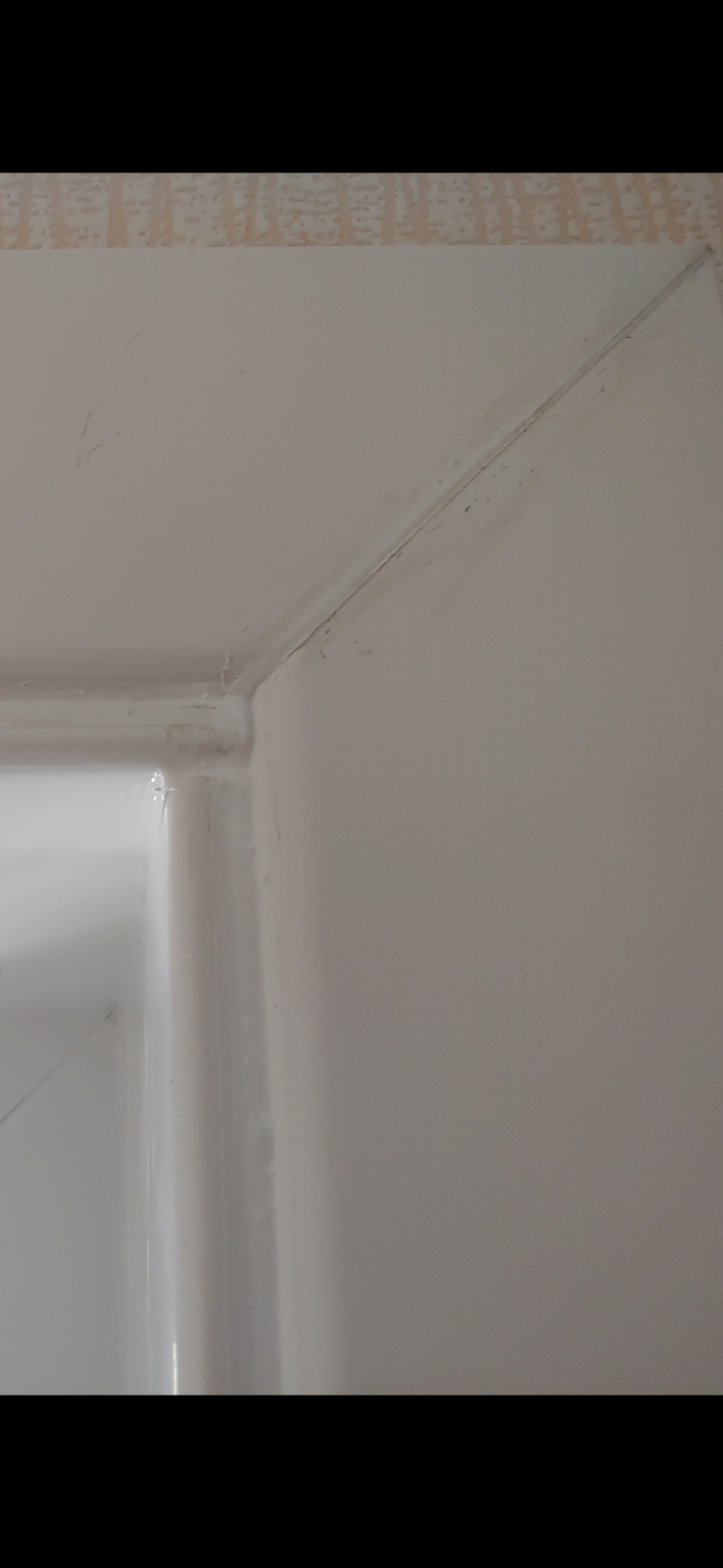

Im about to email a list of defects to the installer.
But unsure of the name of bonding/sealant used in the picture.
Should the trim(architrave) be over the top of the other trim and not be sitting behind it??

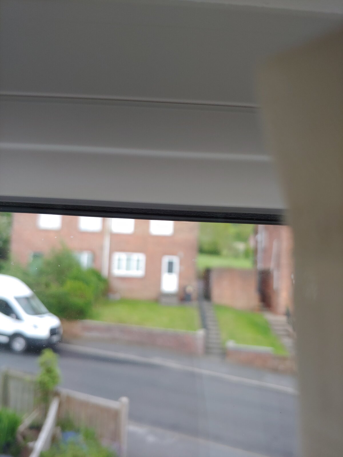

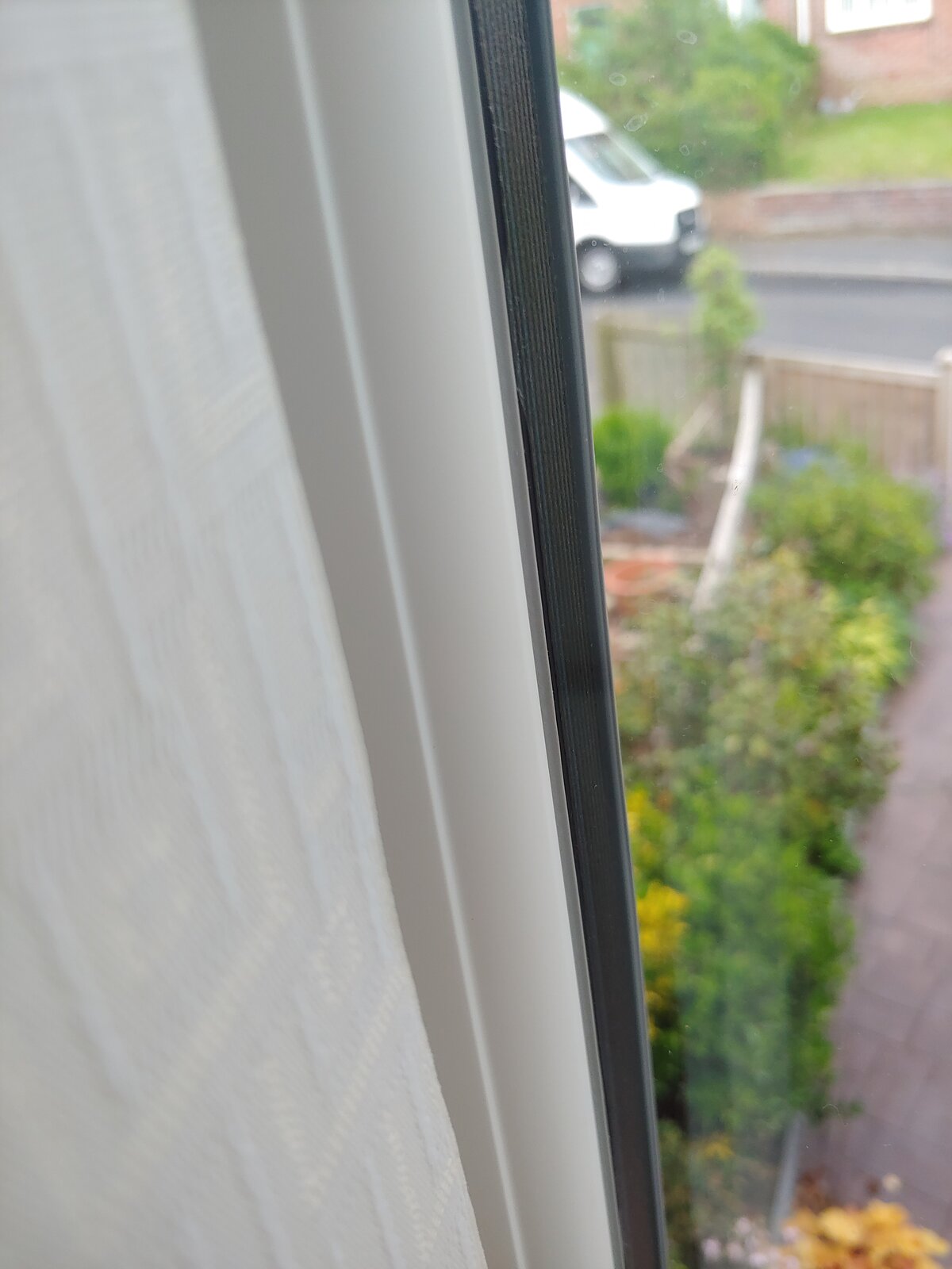

Also how far should the panes of glass be sitting inside the frame(behind the seal)
Some are 1mm and others 10mm or more.
The general finishing is untidy, poor sealing up, dirty finger prints etc, unsure of the sealant used but ideally low mod neutral cure.
Units should be centralised within the frame and have equal coverage all round, it's not super critical to be millimetre perfect but I'd expect to be within 2-3mm not 10mm, if you have some windows that are very close in size to each other it may be that the units are in the wrong windows but I can't say that for certain without seeing and measuring every similar size window you have
The sealant which is in the pic is rock hard unlike silicone. All the dirt is stuck there now

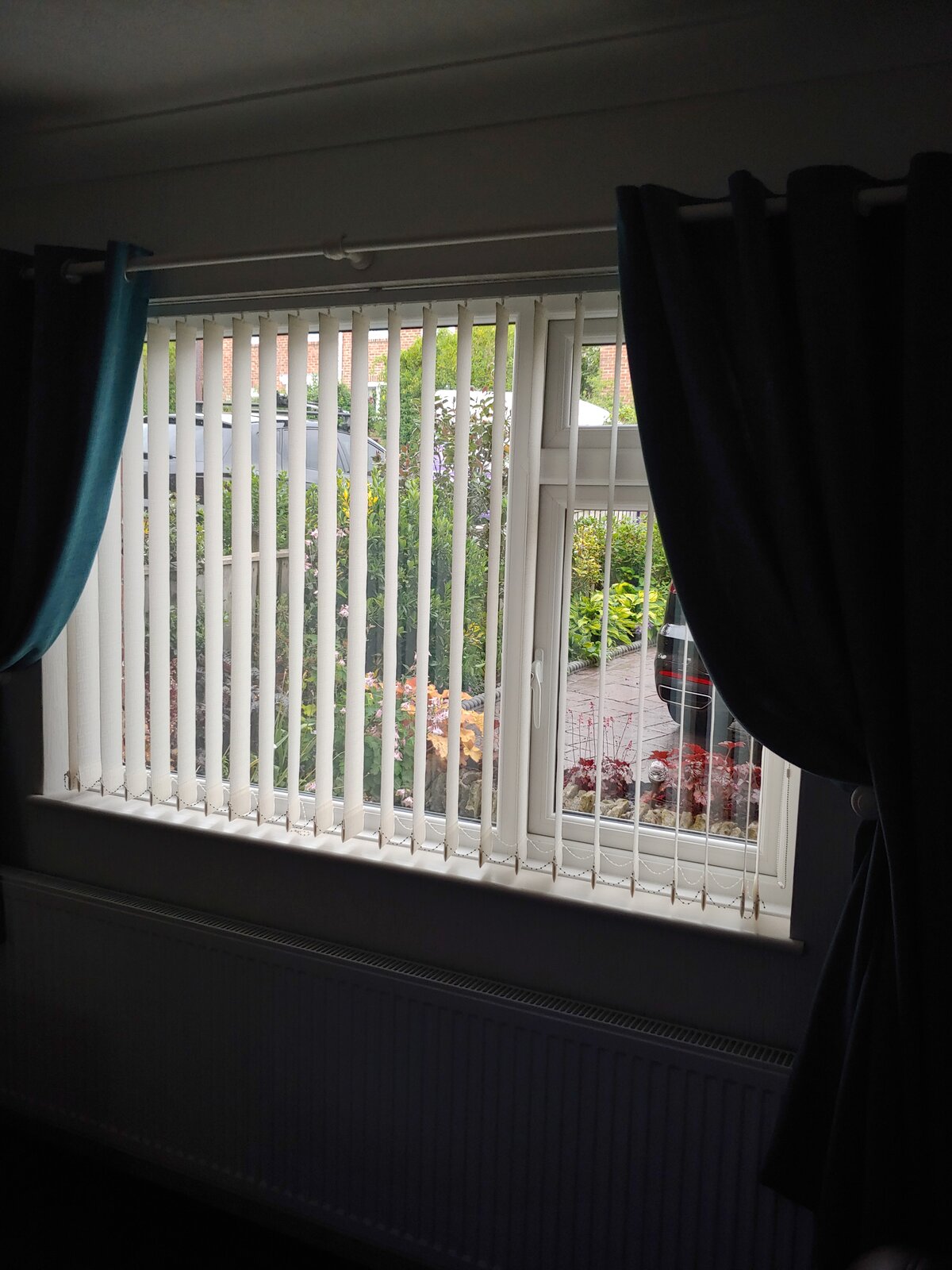

The front window has 3 panes each one is central in the frame but the big pane looks too small as it is on the very edge of the seal.
I hope this makes sense
