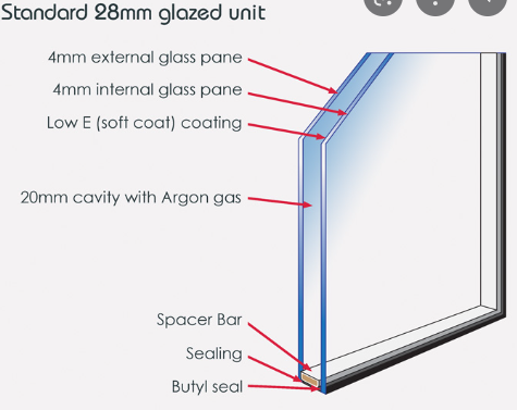

No, just air, or in some cases a gas filled, argon gas - but the gas quite quickly leaks out to be replaced with air. My understanding is that it is really difficult to make a sealed unit completely sealed, they do all have some slight leakage. It's only when the leakage becomes excessive, that moisture gets in.

What causes the seals to fail is not air but a combination of sun(heat), seals hardening off, expansion/contraction and vibration or movement, the seal will crack or break down allowing air and thus moisture into the cavity, the dessicant will do what it can but once saturated the moist air will condensate on the glass. In glass unit manufacture I'm not am expert - you need to ask @ronniecabers but my understanding is glass units have never had a vacuum, they're either sealed to normal atmospheric pressure or filled with argon or similar gas. I know this from old and from 30years of being in double glazing and the last 20 as a service engineer is that after 3 to 4 years the argon or whatever was pumped in at manufacture will be long gone and replaced by bog standard air, the dishonest industry will not tell you that, the honest will and I'll let Ronnie back me up on that and Ronnie manufactures DGU's.
Going back to what DiyNutJob says, then he must be a lucky one because its a well known industry fact that in timber windows where linseed putty is used its the linseed oil that attacks the seals, it was thought that after swapping to butyl based putty a solution was found but that also attacks the seal, even the chemicals in silicone will break the seals down. But of course in timber windows drainage is also a contributing factor in blown units as it was never incorparated into the frames like it is in pvc
I will confirm everything @crank39 says. No vacuum in a sealed unit, just normal air, unless argon/krypton gas filled which WILL leak out over a period of years...usually by 5 years its all gone

I am afraid you are very much mistaken there @DiyNutJob . ALL sealed units have dessicant . Also very very few sealed units are sealed in wood with putty these days. No manufacturer of sealed units will warranty a unit puttied in. One , due to Linseed oil degrading seals and two, putty cracks over time and let's water in , and a lot of wooden older frames had no 'drainage ' ( as upvc does ) and thus this lead to those with cracked putty ' sitting ' in water

Basically a sealed unit is sealed using a hotmelt ...190 degress c plus and they start at one corner and work round to the unit to that corner .. as you get to the beginning it is no longer 190c and you end up with a ' hairline ' fault, very rarely visible to the naked eye. Now all the materials, wood/pvc/sealant/silicone/putty/beading even glass to a degree , contract and expand in the ever changing weather. This creates an unnoticeable reverse bellows effect and slowly draws any moisture in the air /wood / sealant etc I to the sealant unit. Now the dessicant ( actually to be technical it's molecular sieve ) will absorb the moisture and any chemicals until it is fully saturated and then you end up with moisture in the unit. Now this can happen quickly or slowly depending on various factors , how long the unit was left before it was sealed , quantity of water vapour in the air at time of sealing , whether there are any chemicals in the air...some will fail quickly, some slowly.....BUT they will all fail at some point that is a guarantee. South moving round to West facing will fail first due to most of our weather comes that way, regardless of wood or pvc. The industry started to refuse to guarantee into wood with putty due to issues previously mentioned... in fact some manufacturers won't guarantee into wood at all, some if only glazed certain ways but Putty and just silicone are not normally covered. As another thing if the units are going into wood they should not have the ' edges 'taped , as there is a potential to hold water within the tape.
