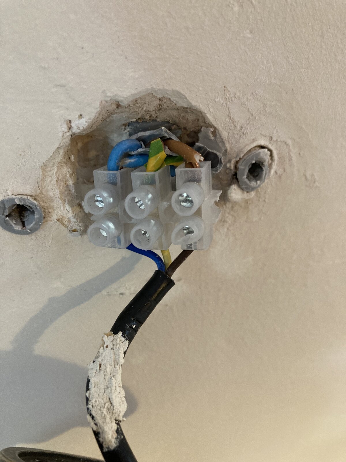

This is a pic of the wiring. I’ve just capped them off for now. The cable will obviously be cut shorter eventually.

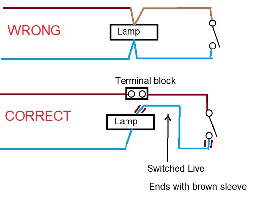

Yes, this is common where a fitting that has feed(s) and switch wires present at the fitting and has been wired with the reds/browns connected to each other and the blacks/blues connected to each other. This causes the fitting to illuminate permanently with the switch off and trip the circuit protective device when switch is turned on.
Hi Adam, in terms of the connection to the fitting. There are two brown wires in one hole, two blue in another and two earths in the third hole. They are doubled up as the lamp also connects to another identical lamp further along the wall

So here’s the wiring inside the light fitting. Left - blue x2 middle earth x2 right - brown x2.
