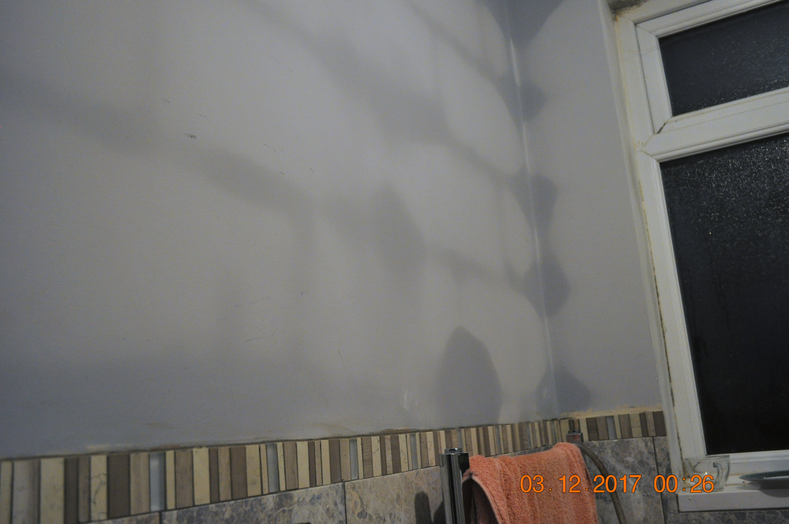

Newly Half-tiled bathroom, upper plastering showing large damp areas.

First sign of cold weather and large damp patches, mirroring the breezeblock/mortar layout have appeared. The tiling shows no signs of unusual dampness. This seems the opposite of what I was told - i.e. that the plaster areas would absorb any moisture.

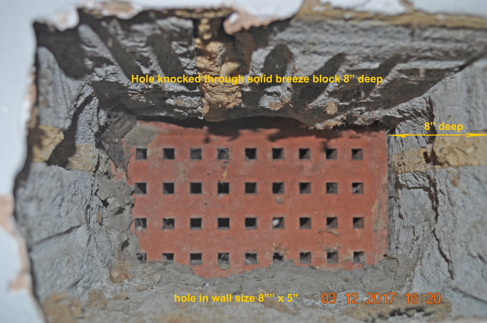

The extractor fan was not installed owing to the bathroom installer 'not doing electrics' so the existing rectangular 'hole in the wall' is just loosely filled with draughtproofing felt - which could easily be removed.

I have emptied the vent hole to reveal an 8” deep wall to exit tile, knocked through what looks like solid breezeblock leaving an 8” x 5” hole in the wall. I had hoped it might be cavity breezeblock, but no such luck. I will have an extractor fan wired in to this position.

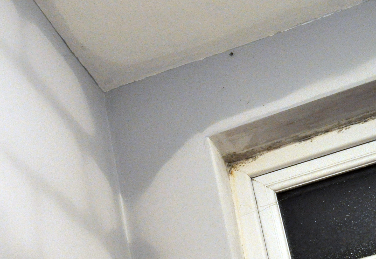

Bathroom paint will stop the condensation being absorbed by the plasterboard and changing its colour, but you may get condensation running down the walls. Are you getting condensation on your tiles?
An extractor can only help by removing some of the water vapour that is condensing on your walls. Both paint and extraction will help with the mould problem you have round the window.

The tiles at present are not streaming with wet, that's all on the plaster, but, undoubtably once the foil/plasterboard interface plus bathroom paint is installed, there will be a new problem, only to be solved - contained - by ventilation and fan extraction.
But, at least, and crucially given the building's weather exposure, there will be no moisture coming in from outside triggered by the temperature differential.
