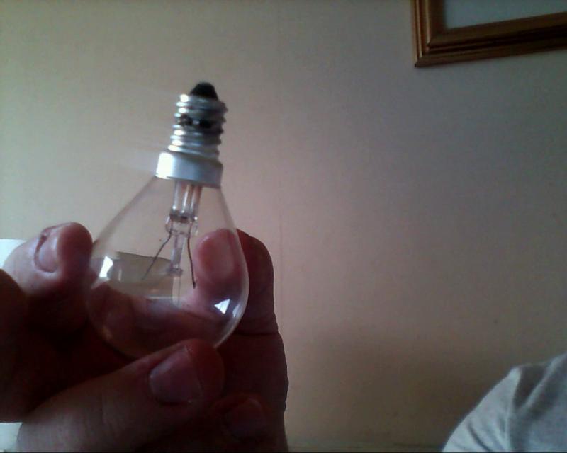

I have just fitted it in accordance with the instructions, and turned it on. 1 bulb blew immediately again with a fairly loud crack. A 2nd bulb blew a couple of seconds later, and the 3rd stayed lit. Looking at the bulbs that blew, there is scorching & a hole in the base of the bulb, on the side of the screw section, and the filaments have burst.

Nothing blew other than the light. I haven't replaced the bulbs as yet (truth be told electricity scares me a bit & I don't want to risk further damage) as where the bulb screws into the bulb holder is slightly melted & doesn't look like a "normal" blown bulb.

Get some new branded bulbs for your new fitting and it should be ok. Manufacturers like to keep costs down by buying the cheapest lamps they can, and cheap lamps are not going to last. It's not unusual at all for the lamps that come with fittings to fail very quickly, especially with all that vibration on the slow boat from china.
Thanks RF Lighting,
Will give that a try. Any idea as to why all 5 of the old ones burst at once? Also is it normal that a new bulb (generic own-brand) would have a hole in the side of the screw-in part which looks like it has been melted?
I suspect your old fitting used 12V lamps, and had a transformer in it which failed causing all the lamps to stop working at the same time.
Not quite sure what you mean about the new bulb, but if it's something like in the middle of this picture, then that is where the wire to the filament is soldered on to the thread of the lamp to make the electrical connection.
