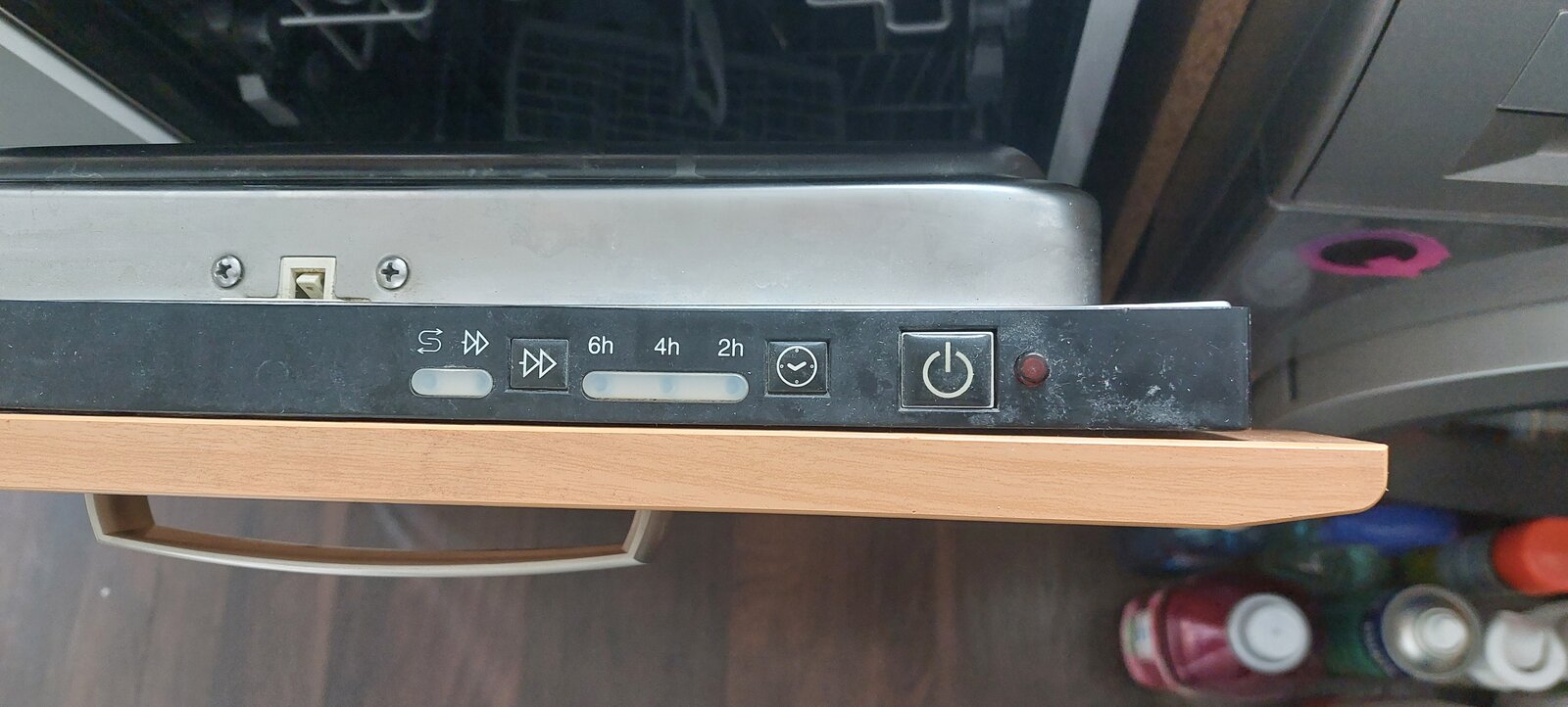

Next step? Circuit breaker switches when I turn on dishwasher.

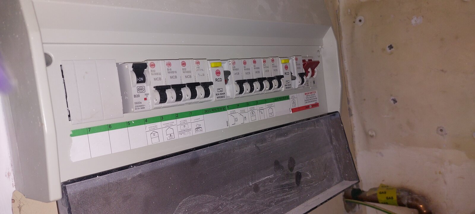

It is an RCD but then so is an RCBO - so it is no good asking if something is an RCBO or an RCD.
Surely you know there is a difference between an RCD and an RCBO, plus what the difference is, and why I asked which of the three it might be?
I know it's an RCCB, that's why I framed the picture that way. I don't see how picking up on a slight detail that Eric posted is relevant to this thread.

Thanks for your replies and apologies for the delay.
I tried switching it on again using an extension lead plugged into a socket in the living room. Nothing happened so I thought I might have burnt out the dishwasher. I plugged it back into its normal socket, tried switching it on and it did it again! Not sure why the extension socket didn't work.
This time, I noticed a very, very tiny trail of smoke and a slight whiff of something chemically burnt coming from the side of the control panel. I think this happened before. It actually forced the main switch off next to the meter this time along with one of the switches in the CU.
