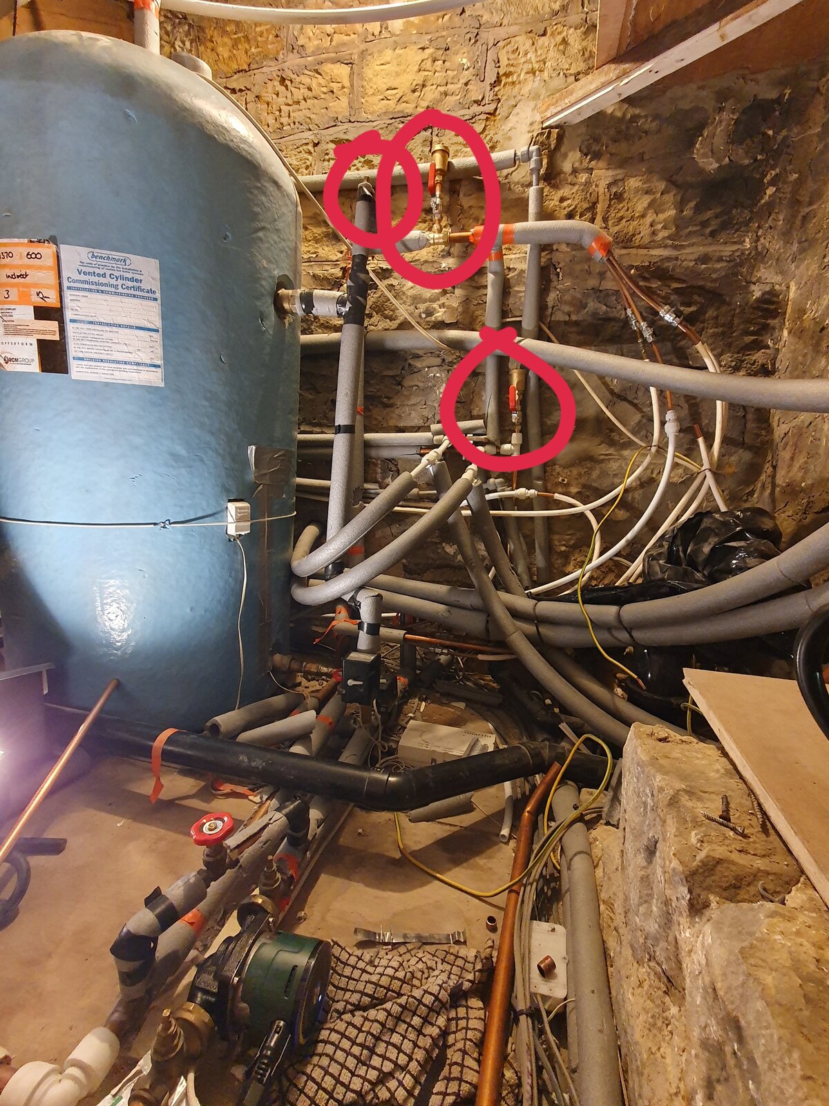

Just an update, managed to finally get it working today, installed 2 AAVs on pipework where it looked like air could collect, there is also a manual bleed valve as well nearby. Still no luck with filling the system conventionally via the F&E tank, so again I back fed mains water through the draincock and managed to fill it up this time. Some purging with the pump seemed to help push all the air through and out of the AAVs, heard plenty of hissing! There is still a bit of air in the system by the sounds of it occasional gurgling etc but hoping it will find its way out of the AAVs.
Based on this does it sound sensible to convert the system to a sealed system at some point in the future? The boiler is actually suitable already...
Red circles show my new AAVs and the manual air vent. The higher AAV is on a high point return leg that covers all the rads but not the cylinder. The lower AAV is on a high point flow on a flow leg covering 4 rads, was hoping there would be enough flow through these to look after any stuck air. As you can see the plumbing generally is an absolute pile of **** some day it will hopefully all be redone. Combined F&E pipe is just out of shot to the left in the flow pipe leading to the pump.
