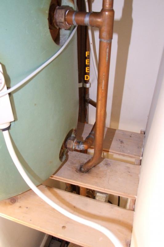

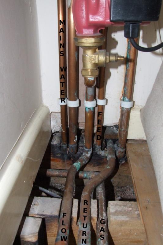

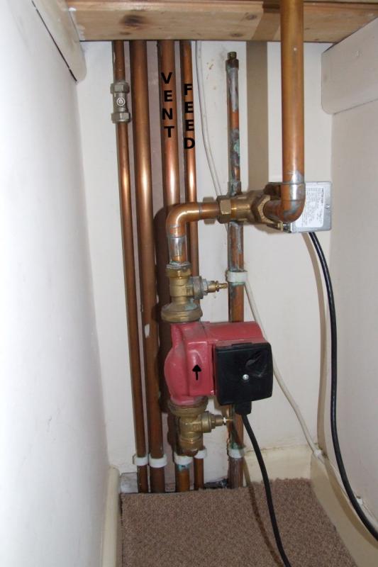

Hopefully the attached will help further. I have described my labels in case I have incorrectly labelled.
Mains water feeds ball cock valves in F&E cistern and DHW attic cistern.
Feed is from pipe in bottom of F&E cistern.
Vent is pipe that hangs over F&E cistern, the one I am to extend.
I have highlighted pump direction.
This lower section of the feed pipe is also the return from the hot water tank coil.
Aha
It appears that the Vent is attached to the suction side of the pump, is that right?
But the feed appears not to be
That would cause a pressure difference between the two, and the vent pipe to suck air.
It might always have sucked air, or it might have got worse with a bit of sediment or faster pump, or if the pump has been replaced the other way up.
That piping needs to be changed. The feed and the vent should both be on the same side of the pump, and only a few inches apart.

Having studied some diagrams on other sites the follwing doesn't seem quite right. The return from the hot water coil goes into the feed pipe and then into the return to the boiler all in 15mm, as pictured below. Is this OK? I read up on the 3 Tees Rule.
your system is piped wrongly. the feed and vent should be arranged as said earlier. the vent pipe should be AT LEAST 450mm above the water level.
the corrosion on the vent pipe says it pumps over, probably just a slug when system is turned off.
until the pipework is corrected there is little point in doing anything else.

I then opened up the drain but left the cold water main supply on and just left the system flushing through. No idea if this was worth it. It was recommended to me to tap/lightly hammer the elbow where the feed meets the boiler return with the fresh water running through it as it may dislodge a suspected blockage. As you can see it's quite tight in that cupboard and the install is quite neat and tidy so thought I'd try this before chopping a bit of pipe work out to visually inspect/clean.
The thing that's on my mind is that the F&E cistern emptied quite quickly, placing my finger over the feed hole in the cistern proved there was good suction/vacuum at this pipe too. Would this be the case with a partially blocked feed?

you need to start by moving the Vent pipe connection from the suction side of the pump and putting it next to the F&E pipe.
