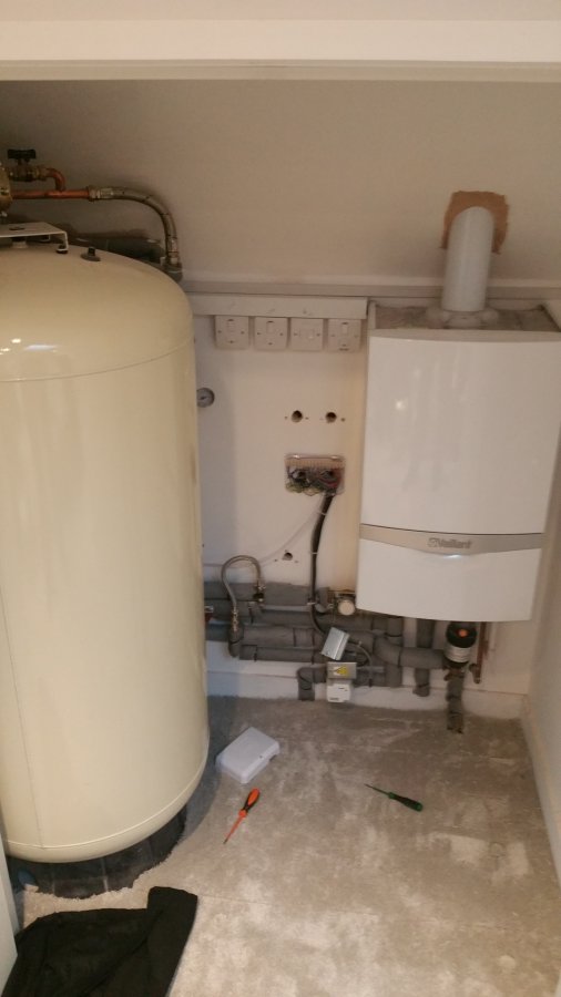

Hi
I am having a nightmare with my boiler installation company. I was quoted for a straight conventional boiler swap as my current tank system is really good.
They have installed a Vaillant ecoTEC Plus 418 boiler and they cannot wire the programmer or thermostat to work. After several visits they have told me that they will need to install a new tank system to make it work correctly (costing me more money).
I currently have an open vented thermal store with a mains pressure coil that has two pumps (water and heating) with no valves. The water pressure I get form the current system is amazing.
Apparently there is a problem with my current system and the pump override on the boiler and if they wired the system to work it would not comply with building regs.
Any advice would be appreciated. If anyone knows how to wire the programmer and thermostat to this boiler/system then please let me know so that I can inform them before I have to pay out for a new tank system.
Thanks in advance.

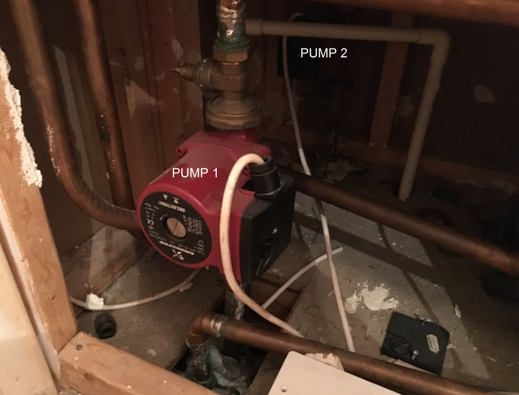

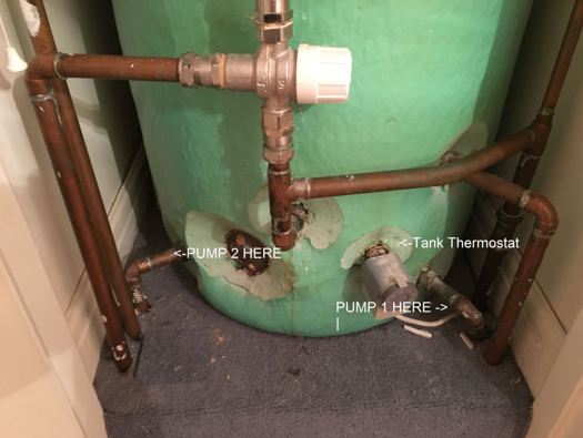

I think that is correct. I have attached 2 photos showing the pump and tank.
Apparently there is a problem because the new boiler has pump override where the boiler will switch off and the pump(s) should keep running.
They are saying that the new boiler cannot function with the current system that I have. Surely modem day boilers should be compatible with older existing systems (installed in 1997). You can still purchase Unvented Mains Pressure tanks (I think).
As wannocks says the primary pump should be wired directly to the boiler so that it can control the over-run, the boiler will also need a permanent live to it.
The boiler and hot water will be controlled by the clock and tank thermostat.
The heating pump will be controlled by the clock and room thermostat.
