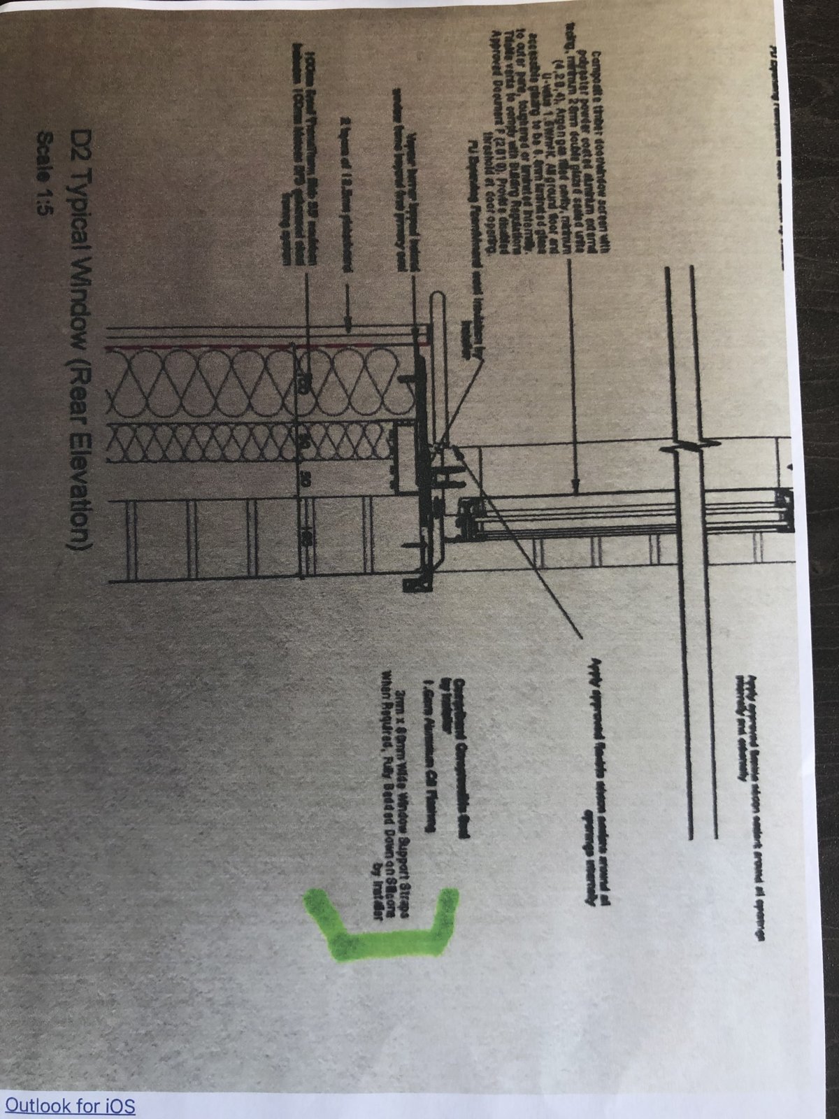

You will see it in the photographs, the untreated plywood. I had a gap between the wall and the internal window cill, the silicone had come away and there was a gap going down the inner cill allowing cold air to come through creating moisture. The internal cill is off and you can see a long gap. I stuck a straw down this gap and there was nothing and this goes to the cavity.
I checked two other windows and they are also missing cavity closers. I telephoned the NHBC as the building is only four years old and they said it’s up to the builders/Hyde Housing Association to sort out.
There are about 100 windows probably will no window closers on this development. I ask Hyde to fit cavity closer in all five of my windows as it was a fire barrier, they said no..!
