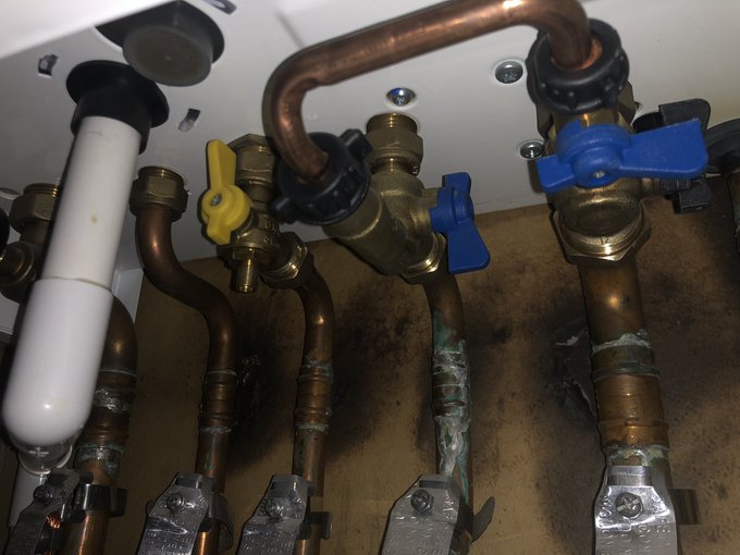

Is it possible that some of the valves are not set up right?

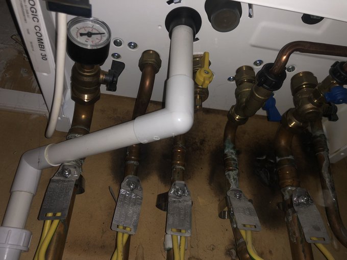

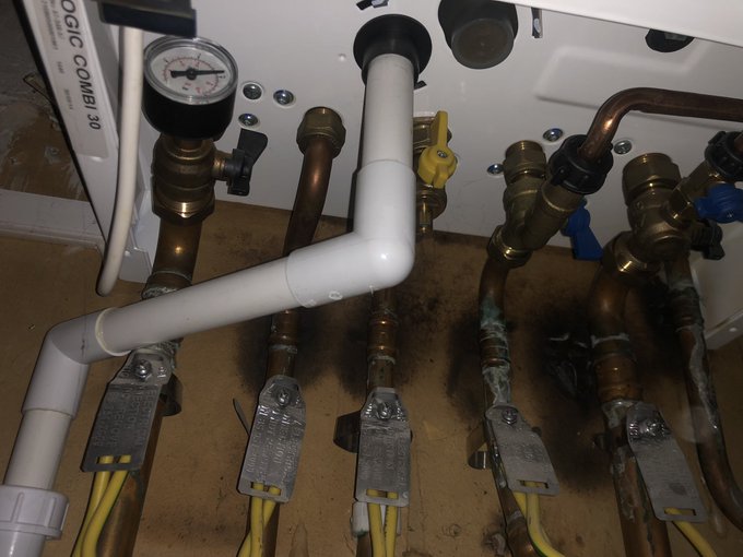

The pressure is about 3 bars, with a maximum of 4
That’s far too high, confirmed with your photos, so likely the heating or running hot water for long periods will knock the boiler off. Some have a low and high pressure cut off.

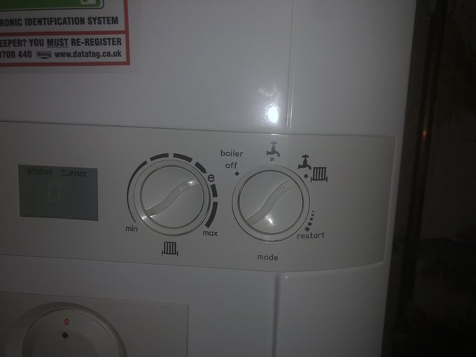

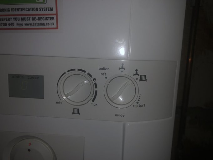

Just seen your video, the thermostat is now paired, a very common fault on your boiler , is that the spindle behind the control knob on the CH/HW control knob snaps, it feels like you are turning it but you arent turning the spindle, so the boiler might be set to HW only, and turning the control knob doesnt actually do anything
when you turn the mode button on the boiler clockwise to reset does the display change from O to ... then back to O when you release it ?
Do you mean the button on the very right ? So you beleive that the button hitself would be broken ?
When I use the reset feature, the wole display turn off for a few seconds, then the boiler starts to "work" ( make noise and vibration) for a few minutes, then go back to 0 after a few minutes yes.
So at least the reset feature definitely does something. Not sure how to tets if the other features are working normally.

is it possible that some of the valves are not set up properly ? I have tried switching the position for them one by one, to see if something would happen, but it did not seem to do anything. Only one of the pipie is hot. Is there somwhere a guide on how the valves are supposed to be set up ?

I understand some boilers include an inhibitor for both the usual low pressure at around 0.5 Bar and one for over pressure at around 3.0 bar. Your PRV should also operate at around 3.0 bar. Try releasing some pressure by bleeding a radiator.

Then the spindle has not broken (and it didnt go blank it went - as I said :) ) on the mode switch, that is good news for you, to drop the boiler system pressure go to any radiator armed with a bowl or pot of some kind, open the bleed point to catch the water that comes out until the pressure guage drops to about 1.5 Bar, no need to worry about that at this stage , that is not what is stopping the boiler from coming on, when you run a hot tap what does the display on the boiler change to ? And you have cost me a virtual pint to @sbgasman :evil:
