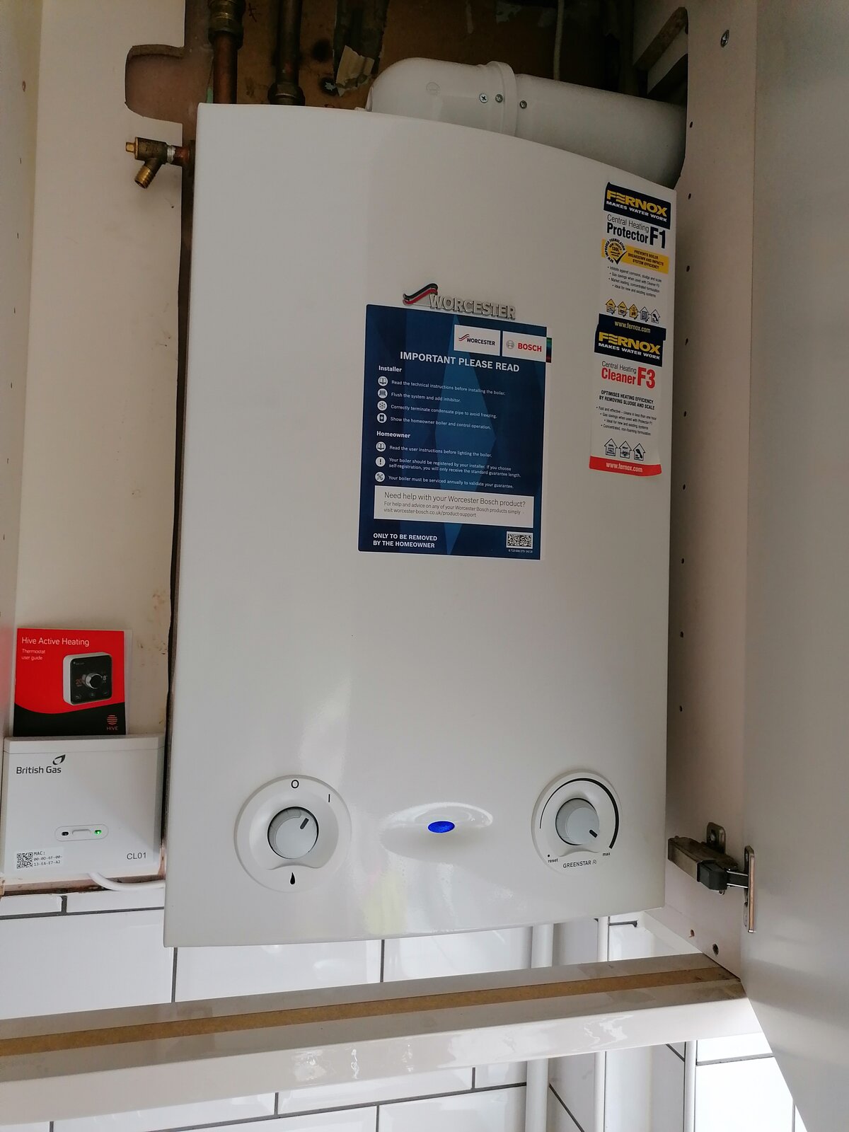

The Worchester Ri boiler has power to it (blue light) but when called for hot water, the green light was either not there or on for a few seconds and goes. Can't hear anything happening but the boiler was getting warm.

you shouldnt have to do all that ona sealed system,just keep the pressure up and bleed the rads one at a time, shouldnt really be affecting your HW though, when you say you dont have HW do you mean water comes out of the HW tap but is cold ? or do you mean no water comes out ? post pics of your cylinder and all controle thermostats etc and boiler

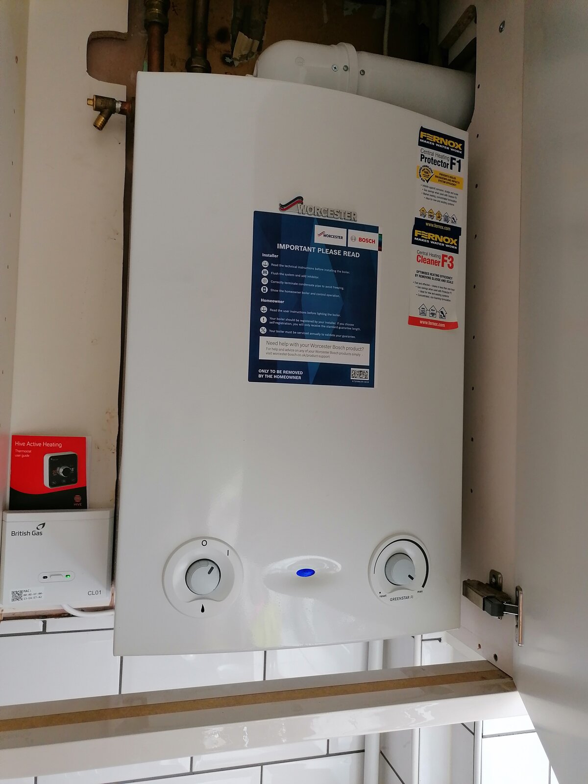

sorry just noticed you have a Worcester Ri so you will have an external filling loop it is not on the boiler, also that boiler has a bleed point at the top of the heat exchanger that will possibly need bleeding , not always though

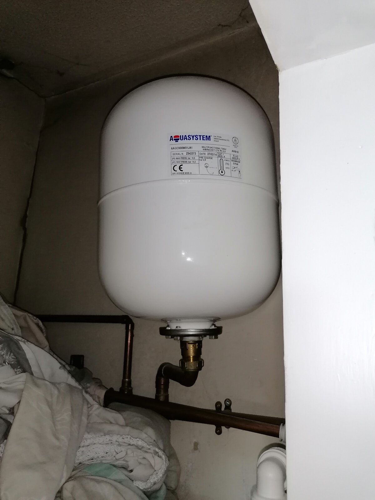

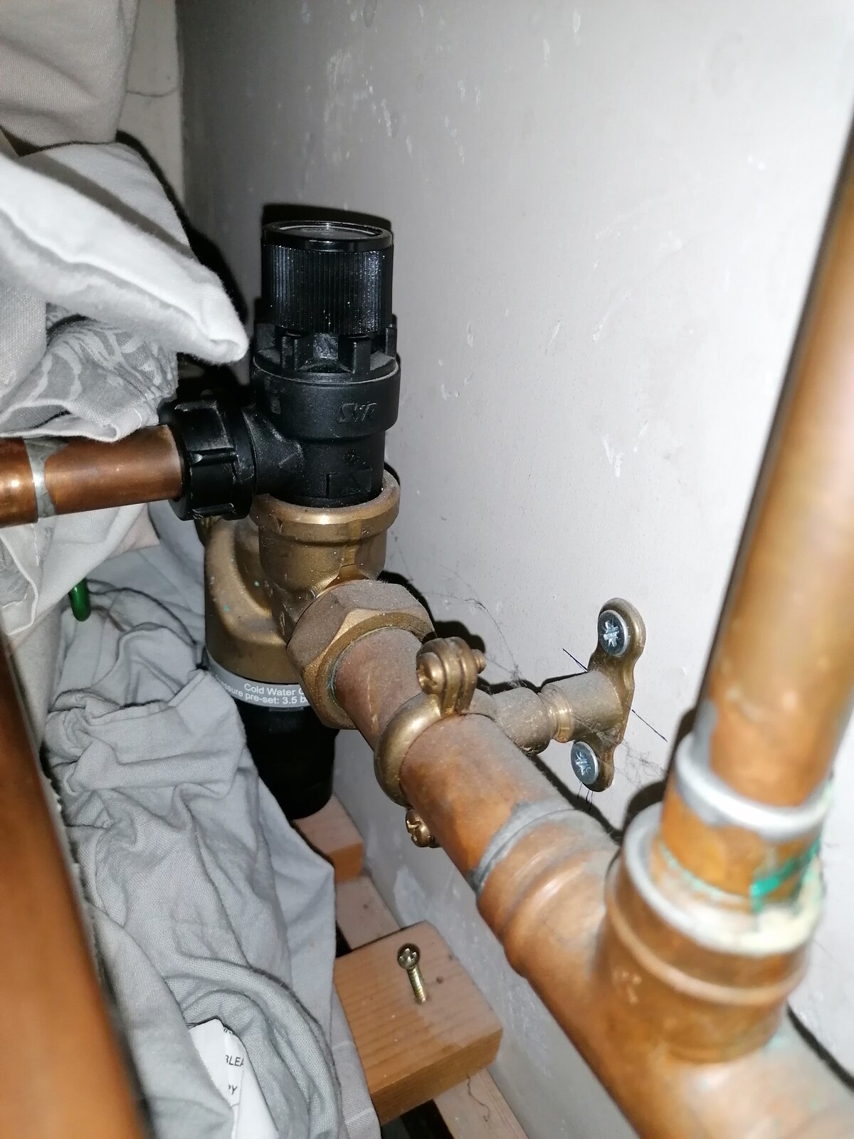

I can't see a filling loop by the boiler. I have an expansion valve external next to the unvented cylinder. However no pressure gauge on this. In fact I can't see one at all!!
Would there be a pressure gauge behind the boiler cover?
Surely this is a traditional vented heating system?
Why did you open the expansion valve on the cylinder pipework? It has nothing to do with the boiler circuit and you may find the valve will continue to drip once activated.

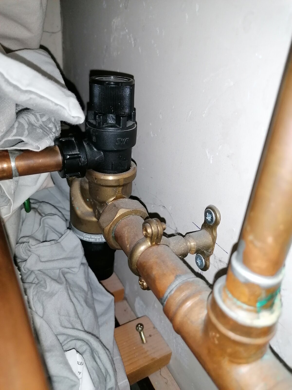

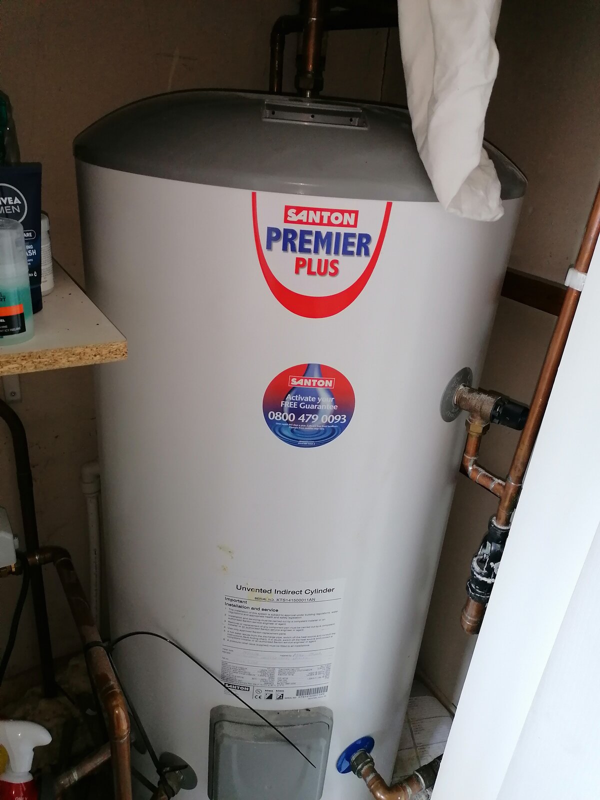

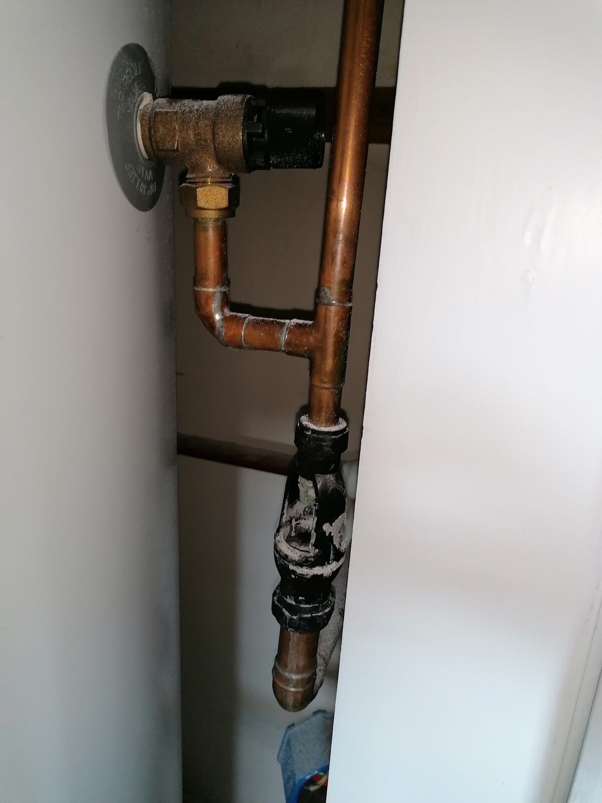

Here is the photos of my setup.

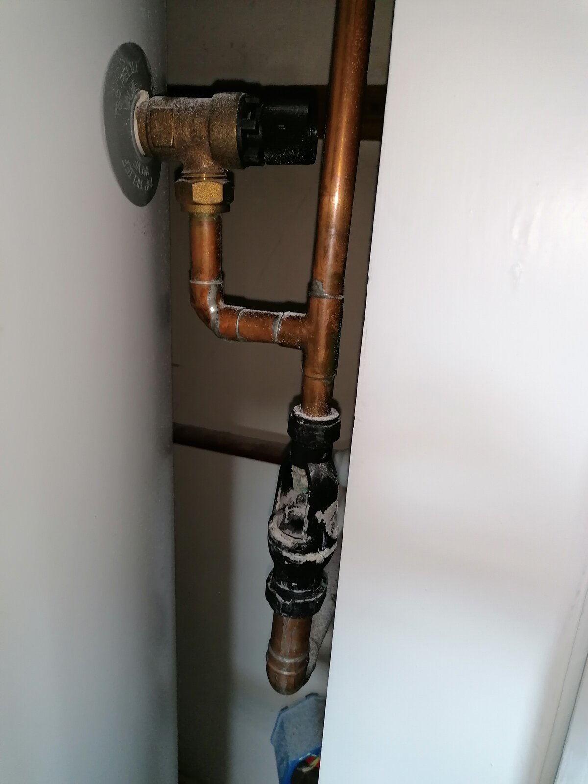

The pressure relief valve is what I was opening yesterday. Do i keep doing this and the radiators?

You've got yourself very confused and are just causing more damage....
Do not touch any safety valves, they have nothing to do with the radiators.
Look at the tundish (the black item covered in scale) and if it continues to drip you will need to call in someone qualified to work on unvented cyclinders to replace the safety valve.
Turn the boiler off until the system is air free otherwise you will overheat it and potentially cause more problems.
Have a look in the roof for a small cistern and if you find it post the pictures back..I am not yet convinced you have a sealed/presurised system.
And just to add the tundish in picture 2 above is not compliant, there should be at least 300mm of vertical pipe below it.

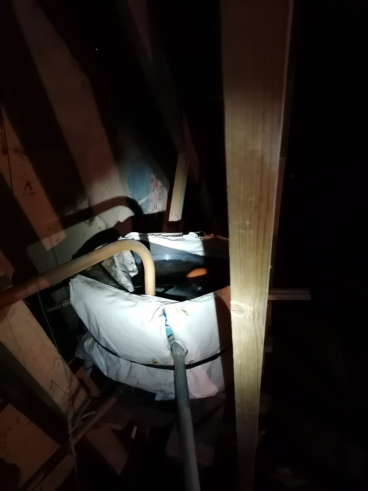

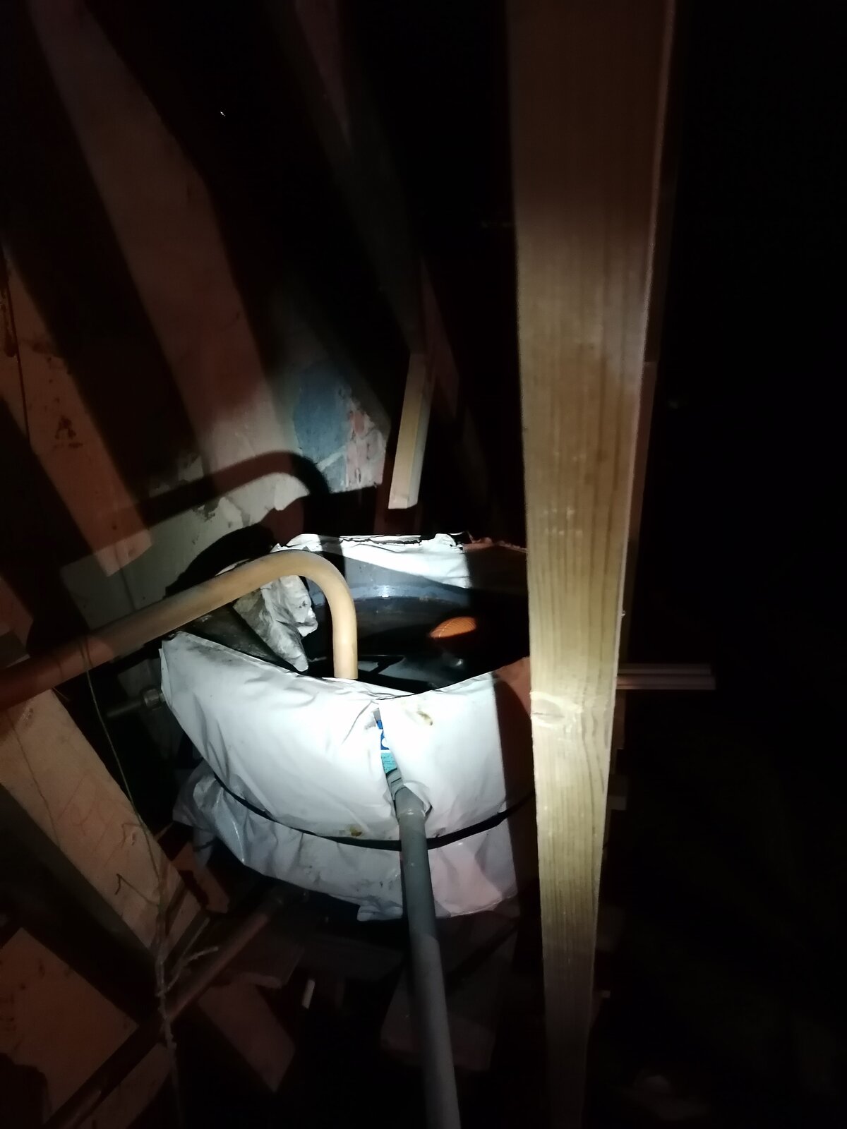

Hi. Thanks for the reply. Attached is a photo of the loft.
I didn't realise this was active and thought it had been decommissioned years ago and left because of the asbestos lining. (that's why we don't go near it) there is low level water in there and a ball float.

Is that really the feed and expansion cistern for the heating cistern..it looks too big.
Post a few more pictures showing the float and water level, there should only be a single pipe coming near the bottom.
