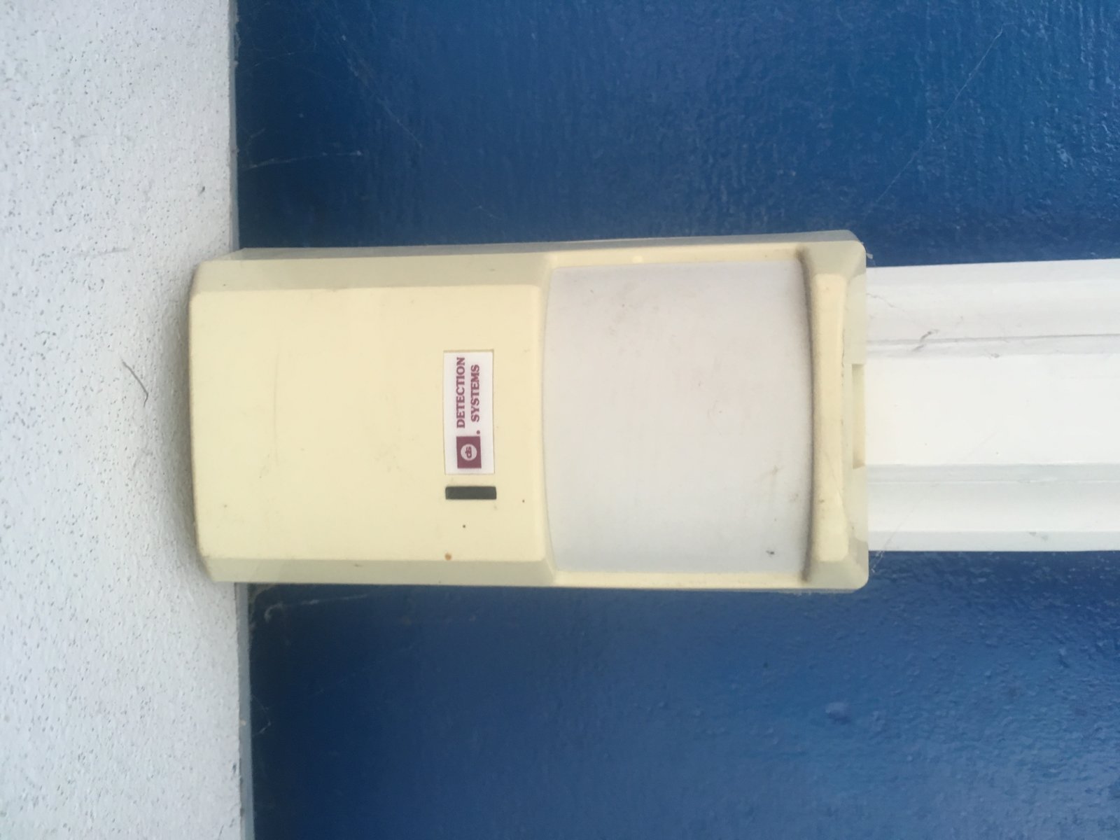

I am in a school with an old Galaxy 500 (V4.5). Looks to be working grand with door contacts but it seems that none of the dual tecs PIR are detecting movement - and we have dozens of them. I can set the alarm and then walk around the school and the alarm does not trigger until I open an external door. What could be wrong?
All the zones are still appearing on the keypad and we have been setting it the same way this 20 years
normally when a PIR doesnt work but contacts do, its power related, although you would expect the zones to remain open and the alarm not set if the pirs werent powered
The PIR's are powered ok. Someone told me it may be the plastic screen lid that has deteriorated and affects the detection capability - does this make sense?
possibly hard to say, this is why annual maintenance is a good thing as the system is tested and any issues brought up and the devices replaced.

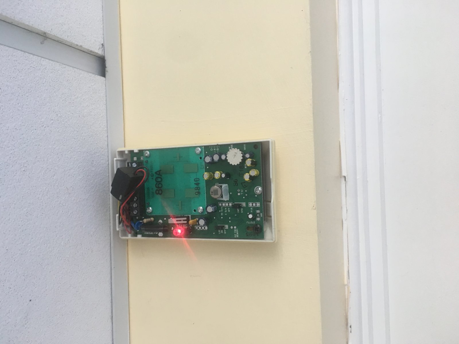

depending on how its wired, you could test the system manually, to see if panel sees the change of state.
Pics
Don't think so - but was probably in engineer mode at the time
....does the red light come on when the front cover is back on and you walk around in the room ?
The engineer broke the cover when trying to replace it and took it away to try and get a replacement
