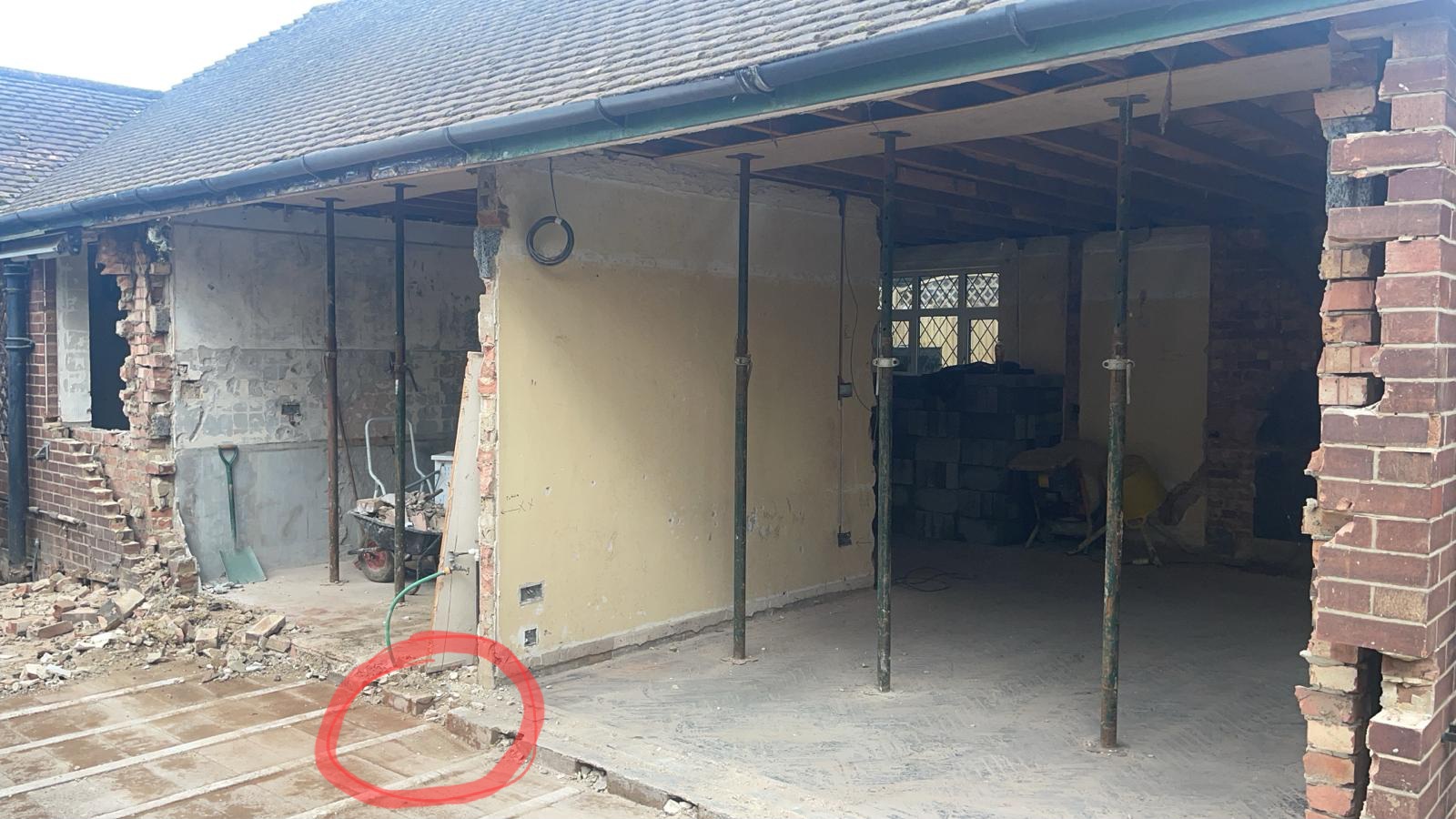

I'm not within 2m of the boundary fence, so the 3m height rule to the eaves applies. So from this pic where would the flat roof go up to be below the eaves, is that below gutters? Or above the gutter below ridge tile

You ought to be more concerned about what exactly is holding up your wallplate as you have supported the ceiling/floor joists with a row of acros's but the ceiling/floor joists sit on the wallplate and it it the wallplate that needs support.
You are a MUG if you continue now knowing you need planning AND you / your architect should have told you this much earlier.
We not continuing. That is as far as the works got. The acros have been removed and supported by steels. Work has since stopped, its a old pic before steels went in. Nothing has been built past floor level.

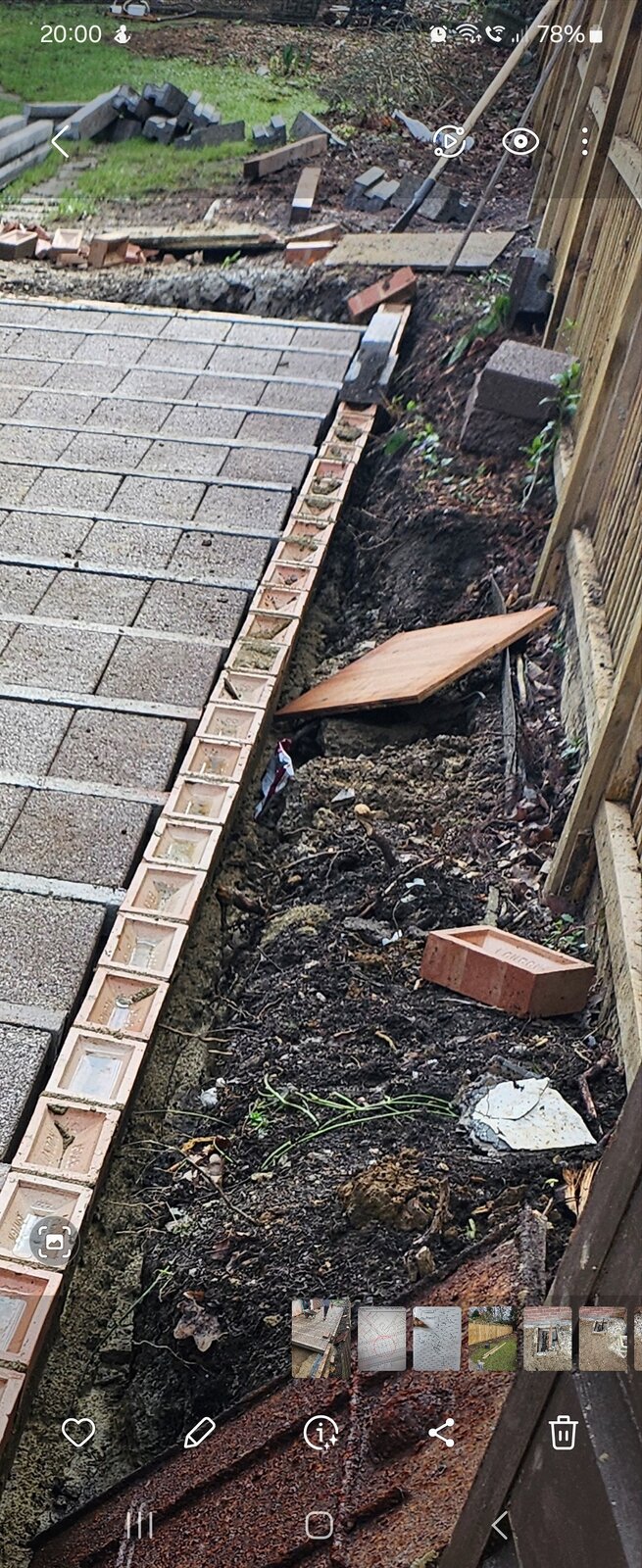

This is all that's been done on the floor level, and work was halted since.
Could the gap cause a issue with the planners up to the boundary, as it tapers in towards the end.
The neighbour has no issues with me putting up a single storey this close.

I bet Building Control have been nowhere near that job. Those bricks are not suitable for that location and there doesn't appear to be any masonry below the bricks I can see.
Is it a shed?
