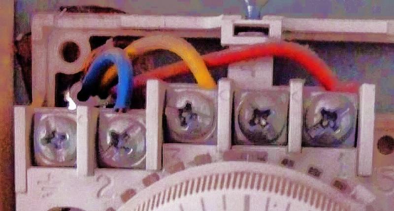

Any better ...OK must be the colour rendering on my screen. I saw blue g/y brown. Sorry.

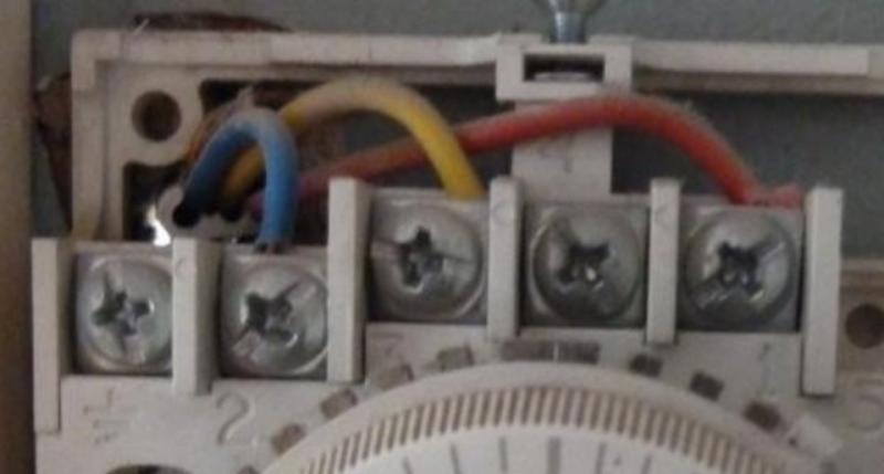

I think you may have described the connections inaccurately.
Ignoring the CPCs (earths) you have only two wires from the switch to the timer but four from the timer to the switch.

I don't see a Y/G at the stat - all I see are red, yellow and blue insulated conductors, and a bare CPC which disappears to somewhere, but is not connected to the stat's earth terminal. Are we both looking at thge same picture?

Ah, I see. Apologies.The other wires into the timer from the switch, come from the connection blocks...
There are 5 in total: the 2 you high-lighted, plus 3 more which are just linked inside the switch patress, to the airing cupboard... (as per the photo)
For my interest, can you say what type the thermostat is?
One last try, then ...I'm still seeing brown. But then it's the same laptop!Any better ...
Of course, I may just have manipulated the image so that the one which should be brown now looks redOh, very good John - much clearer now.
