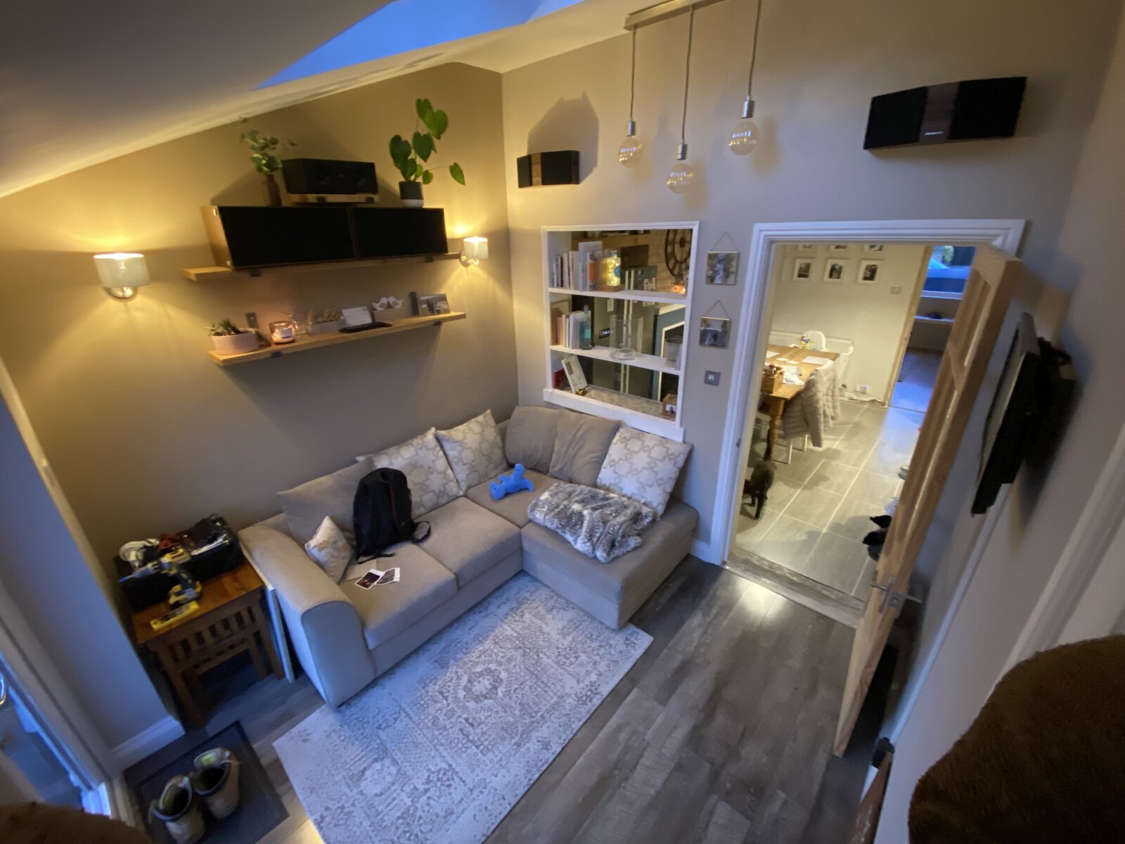

This is the set up I have now. The centre speaker sat above the two mains has been moved to the wall opposite.
A difficult space, acoustically, (although the non parallel ceiling will actually help reduce standing waves). And the speakers mounted against a wall and so high up, away from your ear line. Not ideal.
Obviously, you already have those speakers and a big old Amp, but If it was me, I would use T7Vs or T8Vs front left and right on stands either side of the screen, and some T5Vs in the corners behind your sofa. Or perhaps even a Bose set up with the tiny cube speakers if space is that restricted? You don't need a lot from the secondary peripheral speakers, just a hint to fool the brain into surround sound.
Space constraints mean the speakers have to be mounted on the wall, unfortunately. I do get your points however and in an ideal world the set up would be different, probably incorporating floor-standing speakers as you suggested. I'm still very happy with it.
I listen to a massive range of stuff (mainly '80s new wave and rock, acoustic, '60s pop, classical and Northern Soul). So far all have sounded better than anything I've had before. If we ever move one day (this is just an extension on the back of the house) I'll have a 'better' set up.
I don't have a screen by the way -- this is just a music experience. The redundant TV on the wall has gone.
