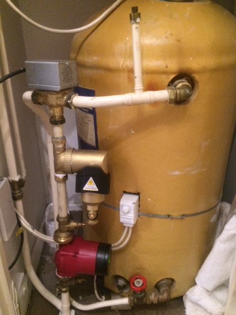

Hello all.
System is a Baxi WM 30/3 boiler (old but has had a new thermostat last year) and does work fine, a new Grundfos intelligent Alpha pump, Magentic filter, Honeywell 3 way valve.
2 tanks in the loft, one tank in the airing cupboard, boiler in the garage
Problem is:
When the hot water comes on in the morning on the timer, the whole system in the airing cupboard makes a whoooosing sound, like there is air in the system, but it been bled so many times now and no air comes out. The noise only comes from the pipes in here. And it stops after around 2 minutes.
What is it and how do we fix it please? Any ideas?

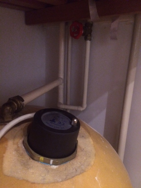

I have uploaded some pictures so you can see the pipe work.
Thanks!
check pump setting ,also put a magnet round the expansion /cold feed connection (l/hand pic joint by wiring box) is should not stick to copper if it does sludge in system

It's the brass fitting at the end of the 15mm pipe which is t'd off the cylinder circuit. (In the first pic, at the very top)
