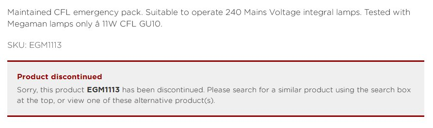

Indeed, but just one problem ... from the Megaman website:
... the "these alternative product(s)" do not seem to appear on the page.
Kind Regards, John

Sorry to dig up an old post, but I posted within it originally! Does anyone know any suppliers who currently offer these? I have spent ages looking around, and there are plenty for 12v lamps, but mine are 230v, or the few that do exist are £100+!
I wonder why Megaman stopped doing them?!
