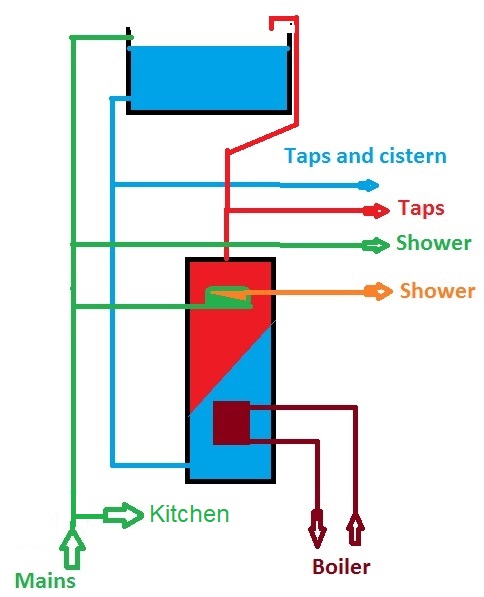

My preference is to have a cylinder supplying low pressure hot and cold to basins and bath and with a shower coil in the cylinder feeding mains pressure hot to the shower.

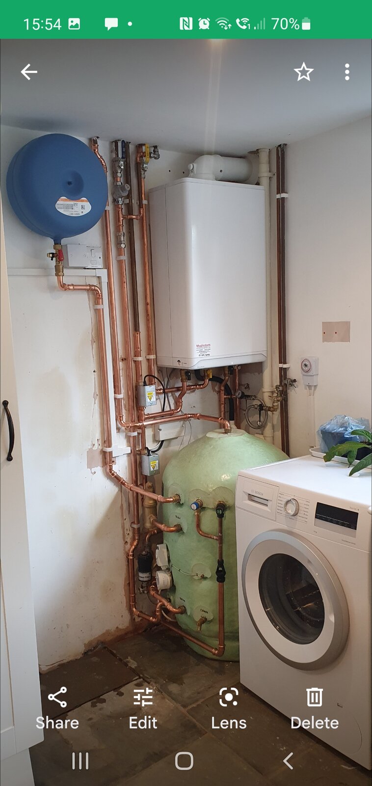

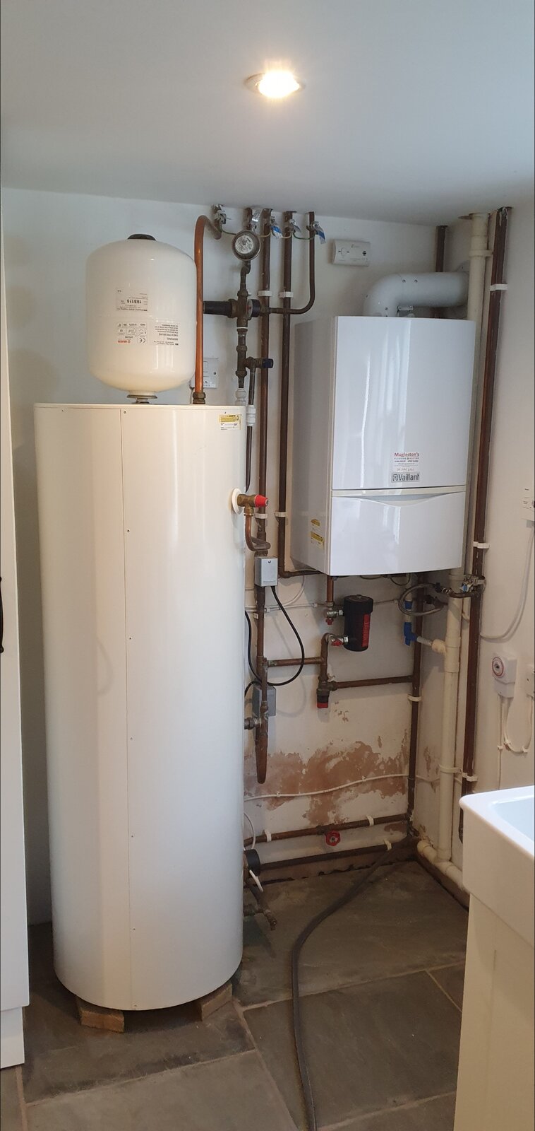

I did this for a customer last year. Despite the new cylinder only being 120 litres, they never ever run out of hot water...
Before
After...
Thanks, I can’t really do that as boiler is in loft so I can’t get the gravity I need (noob here so apologies if wrong)

With an Intergas you can easily set it up for priority hot water and have a smaller unvented which feeds all the taps.
Before
After...
Is this the setup I was originally talking about?
did you do this for the reasons I mentioned…ie to allow shower and taps to be used simultaneously whilst using a combi to provide never ending water?
Yes, essentially. You don't actually connect the hot water pipework on the boiler to anything in this example - it's effectively a system boiler with some clever controls.
The small cylinder has a large coil in it which allows the boiler to put its full power into the cylinder to heat it up very very quickly. Water for the taps is taken from the cylinder, and the cylinder is heated as the water is drawn. Hot water is effectively endless as the reheat time after a draw-off is only a few minutes, and of course it is heating whilst water is being drawn too.
