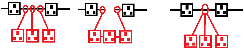

Number of spurs from kitchen ring main.
All three of these options to add a number of additional sockets between 2 existing on the ring final using junction boxes comform to the regs
My preference would be
without junction boxes.
All three of these options to add a number of additional sockets between 2 existing on the ring final using junction boxes comform to the regs ...

My preference would be .... without junction boxes.
Many people would probably share your preference although, in reality, I don't think it really makes appreciable difference - there's not even much difference in terms of 'the number of conductors inserted into terminals'.

The only actual benefit is one less in-line join over the middle option and not having to find a place for it.
Thanks for the replies. Terry yes that's my question. What do you mean by 'final' circuit though?
A final circuit is one that supplies socket outlets or current using equipment directly, a distribution circuit is one that runs from one distribution board to another.
"Ring final circuit" is the proper term for what most DIYers (and probablly many domestic sparkies too) call a ring main.

Aptsys, by 'terminating conductors', do you mean ensuring they reach a socket?
Terminating conductors in this context refers to connecting them to terminals.
This needs to be done in a safe and appropriate manner. Unlike some countries we don't require manufacturers instructions to be followed to the letter, but still they should be taken into consideration. As you increase the number of conductors in a terminal hole or mix different types and sizes of conductor in the same terminal hole, you increase the risk that one or more of those conductors will not be clamped adequately. The design of the terminal also plays a role pf course, oldschool junction boxes only have on terminal hole (well strictly slot) per pole forcing you to have multiple wires in the same terminal . At the other extreme the push-in and lever terminals that are becoming increasingly common are generally only suitable for one wire per terminal hole.
Exactly how many wires is too many for a traditional tunnel-style screw terminal is probably not something everyone will agree on, but I would say 3 is ok, 4 is pushing it and more than 4 is probably a bad idea. I don't think I have ever seen a manufacturer advertise a single terminal hole as having capacity for more than 3 conductors. I find this particularly strange with the oldschool junction boxes as they have four cable entries, yet the datasheet I found for one only specified 3 conductors per terminal.......
If you want to take three spurs from the same junction box, I would suggest the Wagobox 221-4 with Wago 221-415 series terminals.
For more than 3 spurs you could use the Wagobox XL or XLA with appropriate terminals.

If you want to take three spurs from the same junction box, I would suggest the Wagobox 221-4 with Wago 221-415 series terminals. ... For more than 3 spurs you could use the Wagobox XL or XLA with appropriate terminals.

@jocollett after all of that advice, can you advise on what you plan to do.
one important thing that has not been mentioned. If you use junction boxes with screw terminals, then these must be accessible. If the junction is not accessible then they must be products that are classed as “maintenance free”.
There are ready made products that are MF such as THESE
also custom solutions such as the WAGO connectors and boxes.
The type of JB is going to limit the number of connections at any point.
I would not even try to get four 2.5mm into one 30amp JB terminal, the grub screw would struggle to even catch the tread.
One solution, and good practice - is to fit the ring cable into the terminals without actually cutting the ring cable. Strip it perfectly to just neatly fit in the terminals and pass straight through the JB. Two more 2.5mm cables can then be easily fitted in the terminals. Earth sleeving cannot then be fitted on the earth wires, but a small concession to make, for a tidier and safer outcome.
