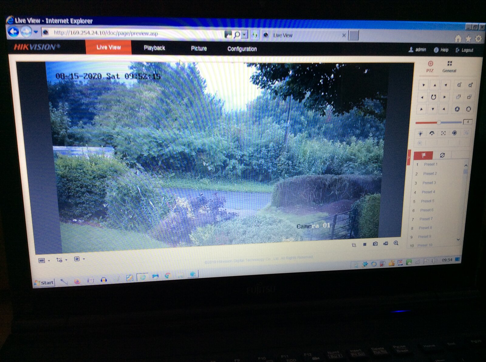

I took the camera to my Sons and plugged it in to his hikvision setup to try it out.
I have now hooked it to my laptop with network cable and tried modifying the network parameters with SADP to suit but my password I registered with isnt recognised...does anyone have any theories on this one please.

probably find its using your sons password, so default the camera and start again.
Yes I can see 192.168.254.2 , if I reset, will that wipe anything anpr settings os the like?

Can you access the login screen for the camera?
If so then you may want to tru your sons login details, as they could have been pushed to the camera from the NVR.

I can log into the camera and even if I enable DHCP it doesnt display a picture
Btw, whats unbinding and is it relevant?
26C1B466-0839-4D3E-BB0F-C10EDFD173A6.jpeg Now have picture logging in with Sons user name and password
The network settings are irrelevant as to seeing the picture.
