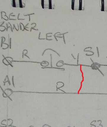

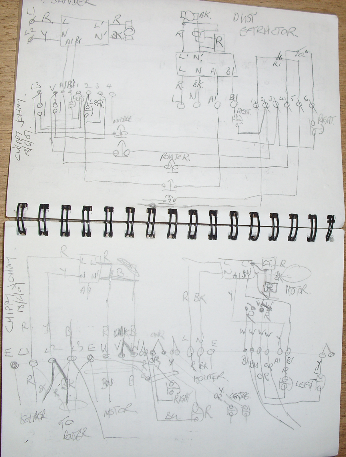

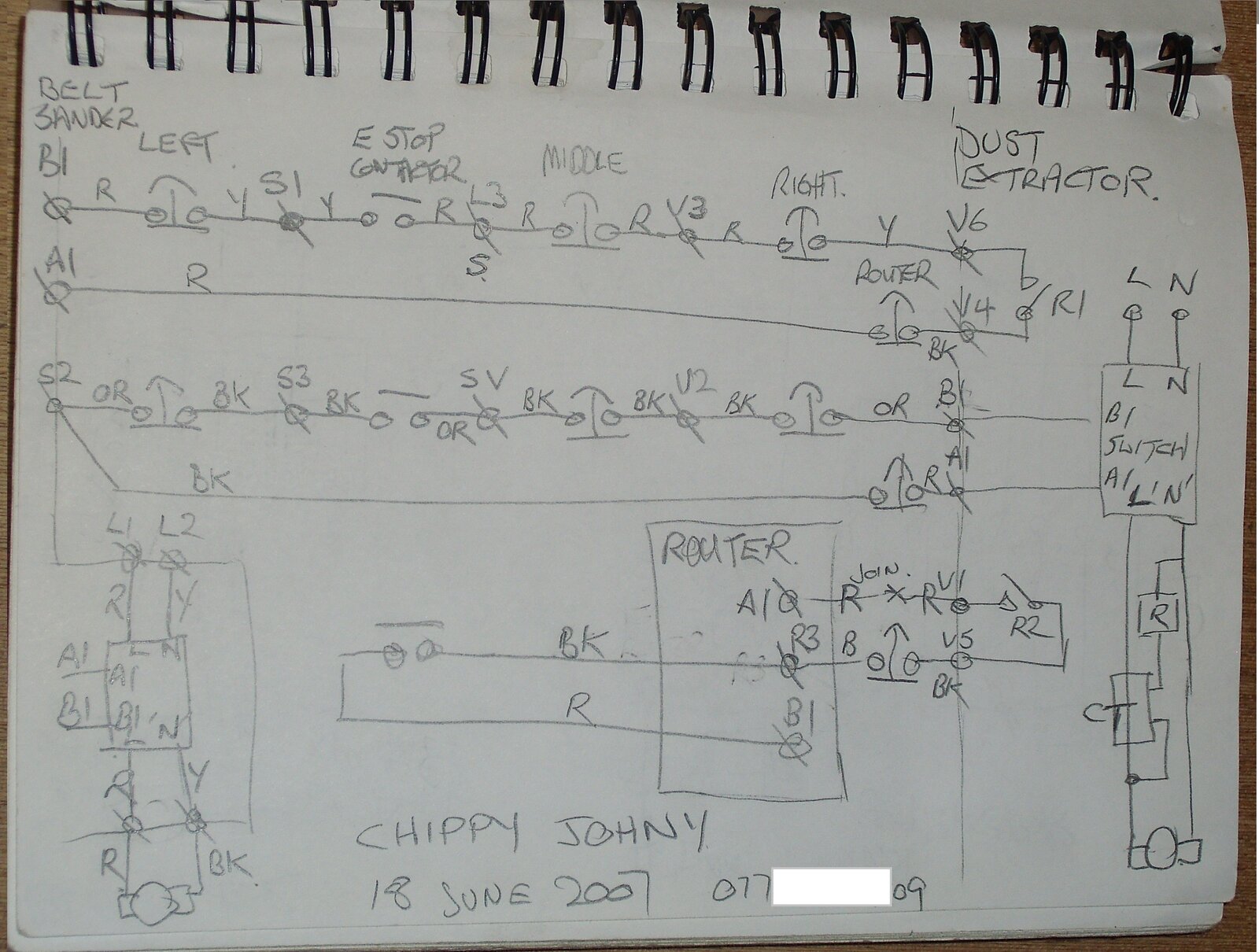

Notes from 2007:
And the interlocks:
I'd forgotten there was a router linked to the extractor too, all told there were 4 E stops, one stopped all 3 machines, the other 3 stopped only 2. There was also a workshop Estop.
I didn't take a note of the switch part number They had the same appearance as OP but I see they have A1 & B1 terminals which needed to be linked to enable it.
It seems the sander was wired for 3ph but a single phase motor and switch fitted.
Terminals designations S (in the sander), V (in the extractor) and numbers were mine, and were bits of choc bloc added in. The CT switch and relay were also extras.
All of the interlock wiring was done with flex, 5C or 3C
