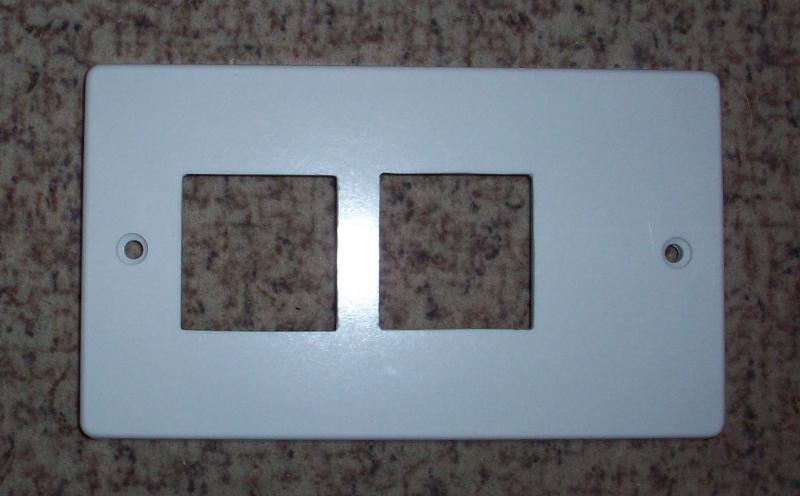

We touched on this a few months ago. I've been experimenting with various ways of housing octal plug-in relays, in situations in which I ideally don't want to have to use a large enough enclosure to totally 'enclose' them (and thereby also totally deprive them of ventillation/cooling) - so I wonder what people think about have the ends of them 'exposed'. For example, one of the experiments is:

I'm not really sure how one could do that. With the sort of bases that are common these days, that would leave all of the terminals exposed; I haven't seen ones with shrouds. I have, in the past, used standard octal valveholders mounted on the inside of the box, with the apology for a skirt around the pins (about 0.5mm , if that, entering an oversized hole in the box, but it's then still possible to withdraw the relay to the extent that it's pins are still mating with the socket, but exposed. Did you have some other technique in mind?
thus avoiding the need to cut rectangular holes, which as you know is impossible to do neatly by hand?
As you may be able to just about see, they're pretty neat holes (even if I say so myself) - but, as you say, they are a pain to create. What on earth is the material that these 'moulded' accessories are made out of - presumably some thermosetting plastic, a modern equivalent of bakelite? Although it's thermal properties are very good for the job, it has to be one of the least forgiving materials I have ever had to work with!
Pretty neat, yes.
Round would be easier and neater. Do it in metal and you can use a chassis punch.
Some kind of polycarbonate, I think. Brittle. Does have the advantage of being rigid though - ABS would be easier to work, but that flexes.
If you want rectangular and neat you could try clamping thin strips of metal across the face to act as stops for your file.
Metal enclosures, chassis punch, bases like the one above - you know it makes sense.
Kind Regards, John.
I agree, bit off centre :D but neat.
Some makes do pvc blanks which are easier to cut

I'm glad you agree - not perfect, but there was a limit to how much time of was prepared to waste just for an 'experiment' which was probably never going to be used in anger:
It is a trecherous material, and what you see was essentially the result of 'dentistry' - a dental diamond burr in a very high speed mini-tool then just tidied by hand/eye with a file.
Off-centre, of course, to leave room for a connector block to the right :)
I've looked, but failed to find such animals. There are plenty of PVC ('conduit') boxes around, but none I've seen have offered PVC blank plates. I have, however, been known to use sheets of more user friendly materials for such purposes!
