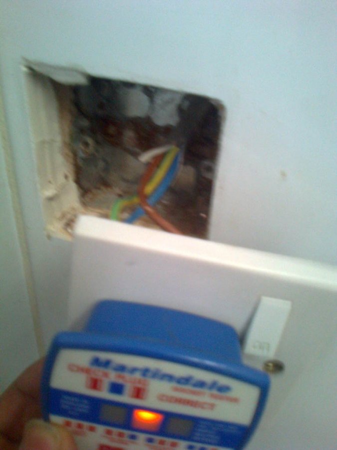

Following the Phase Neutral Reversal post, here's my pic of a Martindale exhibiting a lit neon not explained by the instructions.

Doesn't it mean 'open' earth?
What does your proper tester tell you?

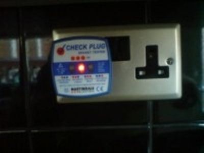

That presumably means the line IS connected to N or E (presumably N, unlikely E)), or there would be no power to light the tester, so it is reversed polarity at that socket.
That's the one I missed, partly because the thumbnail cropped it, rather than shrank it, so in the thumbnail there are no lights visible.
