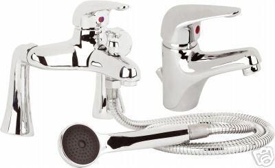

I Have just ripped out my old bathroom suite and renewed the piping like for like. when i installed the bath (changed the ends for taps so i took the feed from closer to the hot water tank but same pipes used) when i fitted the new taps (shower / bath mixer it stated Taps suitable for use on all water systems from 0.2 to 6.0 BAR ) the hot water pressure was very low cold was fine. things i have done.

Have you bought some really trendy, stylish Italian taps?
show us a pic

It also sounds like you have fitted a mixer tap where the cold is from the mains (high pressure) and the hot is from the tank (low pressure). If so, this is wrong and will never work properly.

and yes it is a mixer tap with a shower head on it.
the taps are these

I don't believe it is anything to do with the pump (what you have heard about is I think the Central Heating pump, which is not the case with your problem) or an air lock. It is the water supply. I have a mixer shower fed from a tank, which gives reasonable, but not impressive, pressure and flow. The tank is just over 10 metres above the shower (I have a tall house) which gives 1 bar of pressure . You will not get much from your low tank.
I think the problem is that
(1)your fashionable new taps have smaller waterways in than than the old-fashioned British taps you had before, so you get less flow through them, and
(2) you have mains-pressure cold and low-pressure hot, which never work correctly through a mixer tap.
If you are looking for a straightforward, effective, easy and economical solution to your proiblem, buy some ordinary British pillar taps and sell your mixers on Ebay :(
If you want a more complex and expensive solution, change your cold-water supply to the bathroom taps to a tank-fed (so it is balanced pressure), and add a Shower Pump to make them squirt more forecfully.
If you want a much more complex, expensive and lengthy solution, keep your fashionable taps and change your hot-water system to a Combi boiler or a pressurised cylinder
Basically what John's saying, and what I was kind of getting around to, is that you can't have unbalanced pressures on a mixer tap. The reason for this is that the high-pressure cold will stop the low-pressure hot running out of the tap, so you need to balance the pressures somehow. Incidentally your new setup is probably also in contravention of the water regulations as I am assuming you haven't fitted backflow protection to prevent hot water being drawn into the mains in the event of a mains failure...

New individual taps would solve all your problems nice and simply so do that as JD suggested
