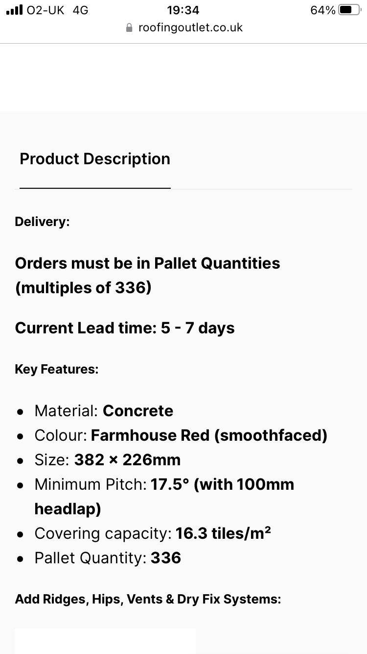

The room in the outhouse has a depth of 3.6m. The ceiling angle follows the joists above it. The height of the room is 2.5m at the front and 3m at the back. So my online calculator gives it a pitch of about 8 degrees.
Oh crap. The roof angle was never built steep enough to cope with tiles was it? That’s why water must have been getting to the felt in the first place.
Data.. they can't be majors if they are only 9" wide, but yes I agree it looks about 20°
just testing.. didnt look closely enough, marley ludlow plus original and redland 49 newer.. that makes my theory even more likely. the ludlow plus are straight top to bottom , 49 have a slight curve...
Those tiles probably need about 25°
He said these were the new ones he bought:
https://www.roofingoutlet.co.uk/pro...8645831__b2484fa2-6dbd-451f-b469-521ff93731ba
Of course when he told me how much he paid for them I showed him that website and he said “you can’t trust those websites they end up supplying cheap knock off equivalents”
I’ve been telling him over and over that the waviness and overhang and the interlocking issue is because he’s used the slightly larger new tiles to create the entire first couple of rows as well as using then in a big area of the on the left at the front. First he said the problem was with the building having unlevel joists to begin with. (Even though he charged me £750 to lift and bolt a joist during his attempt at reroofing. )
When I pointed out the original roof had no issues with interlock/waviness/overhang he finally changed his mind and said if we reroof the whole thing again with all new tiles only then the problem will be solved.
