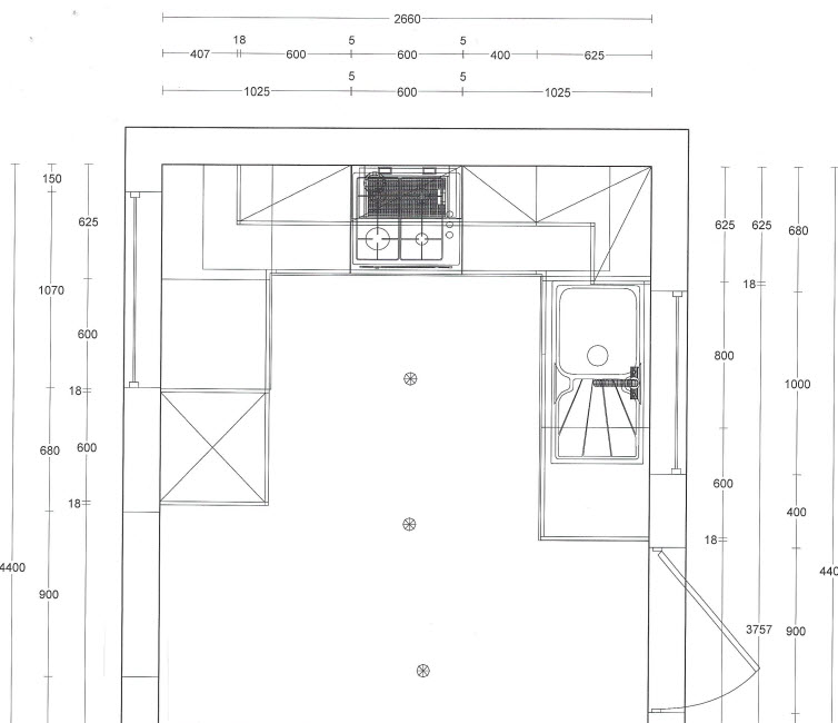

Having my new kitchen extension wired up. I plan to have a hot tap installed (it comes with a 3 pin plug) and it will be positioned at the edge of the kitchen sink. I'm not sure how much cable comes with it.
Since this needs to be plugged into a regular socket (compared to being wired in to a spur socket), is it safe for the plug socket to be located immediately under the kitchen sink or should it be to one of the cupboards to the underside of the sink? Problem is I'm not sure how long the cable to the hot tap is.
I'm guessing the switch for the socket should be located above the worktop surface? A fridge will be located to the right of the sink next to the door in the image attached, corner cupboard to the left of the sink.
Thx.
Perfectly fine under the sink, ideally you'd keep it away from any waste joins / compression joints on copper but in all honesty, the risk is so low I wouldn't worry too much.
There's plenty of places electricity and water are close together but assuming your plumber isn't a total numpty - big assumption :whistle:, then you'll be fine
I have two under my sink, positioned away from pipework, one of my neighbours called the other day, kitchen sockets were tripping, caused by a leaky waste pipe dripping onto a socket under the sink
if you are really worried, fit outside type sockets with a cover. ip44
but covered sockets make "emergency" switch off's harder
I suppose the sockets you are referring to are not surface mounted but regular "in the wall" type ones?

I have a Franke 4 in 1 Omni tap, very useful for rinsing rice / cooking pasta and other items quicker. It has a filter too for both cold and near Boiling water. It's served from a socket under the sink high up away from pipework.
