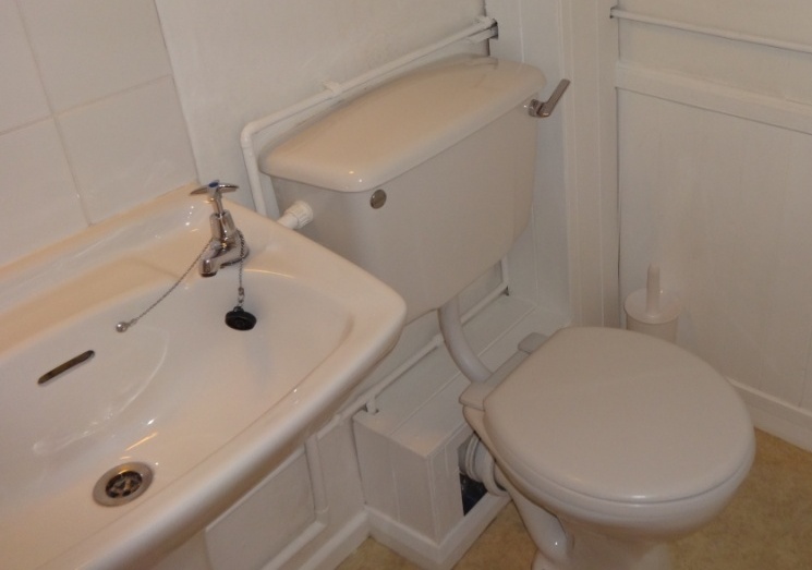

My shower needs to be dealt with quite soon because of leaky tray/waste. If I can delay replacing the loo and sink until another day then it would be beneficial.
However the overflow pipe of old low level wc cistern is currently piped to discharge into the shower tray. Is it OK to pipe the overflow into the sink waste next to the loo instead for now so the shower can be done 'properly' without the overflow pipe?

To comply with water regulations any overflow should run through a tun dish in an accessible location AND the discharge point should be protected from foul smells in the drainage system by a water trap or a fanny flap.

I think OP is intending to just hang the overflow over the top of the basin, not into its waste pipework! Is that right OP?
In which case, you're eventually going to run it back to the shower tray when done - again freely discharging into tray?
If that's your plan then I'd definitely just go for a new flush valve with internal overflow and block the old overflow with a blanking plug and do away with the old pipework for good.

Overflow or (warning pipe) should provide a visual warning of a problem, most used to be direct to outside, new WC's have an internal overflow (visible by water running into the WC Pan) or via a tundish (this gives a visual warning and an air break).
So this should be able to be adapted to be used in my old low level Wc with a lever handle ?
Some photos might help!
If you've a an old close-coupled wc with a fixing plate, you might have trouble decoupling cistern and pan - have a look at the fixings and see how rusty they are!

It probably hasn't been decoupled for ages!

Ok, it's a low level cistern not a close coupled! Should be fairly straight forward to replace the flush with an internal overflow one.
Obviously you can't discharge the overflow into the basin cos it's higher!
