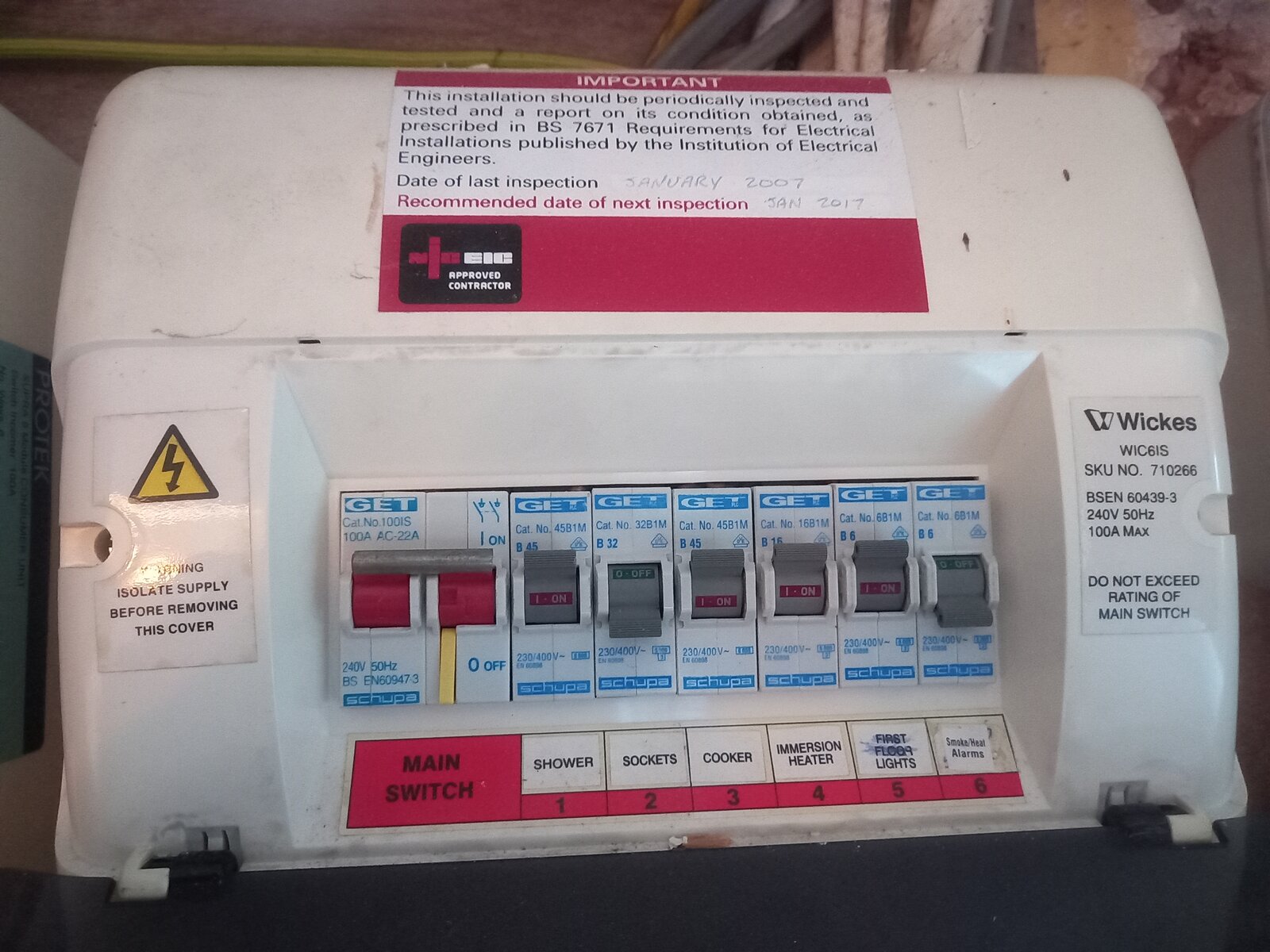

Hi,
I have an old Wickes consumer unit with Get Schupa breakers, the one for the sockets used to trip occasionally, now trips reliably after about 1/2 hour, even with nothing plugges into any socket at all. It's a B32 (32B1M), which is obsolete, I know. It doesn't trip the RCD or anything else.
What are the chances the breaker itself is faulty? Is it worth buying a used one to substitute and test? Chances are I'll end up having the socket ring rewired, and a new consumer unit, but it's maybe worth a try?

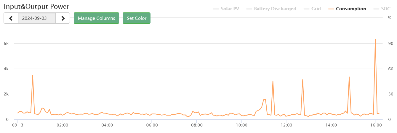

It may well help, this house if I look at the total socket load, in fact total consumption it is not that high.
You can see coffee before going to bed, coffee and a flask 11 am, then another coffee at 1 pm and yet another 3 pm, and a shower at 4 pm, clearly if it trips while making coffee, or having a shower you will have a good idea what has caused it, same goes for washing machines, tumble driers etc. But in the main my socket circuits are not loaded over 4 kW as amps that is 17 amp, so a socket circuit will likely run on a 16 or 20 amp MCB without a problem.

Could you post a photo of the CU?
