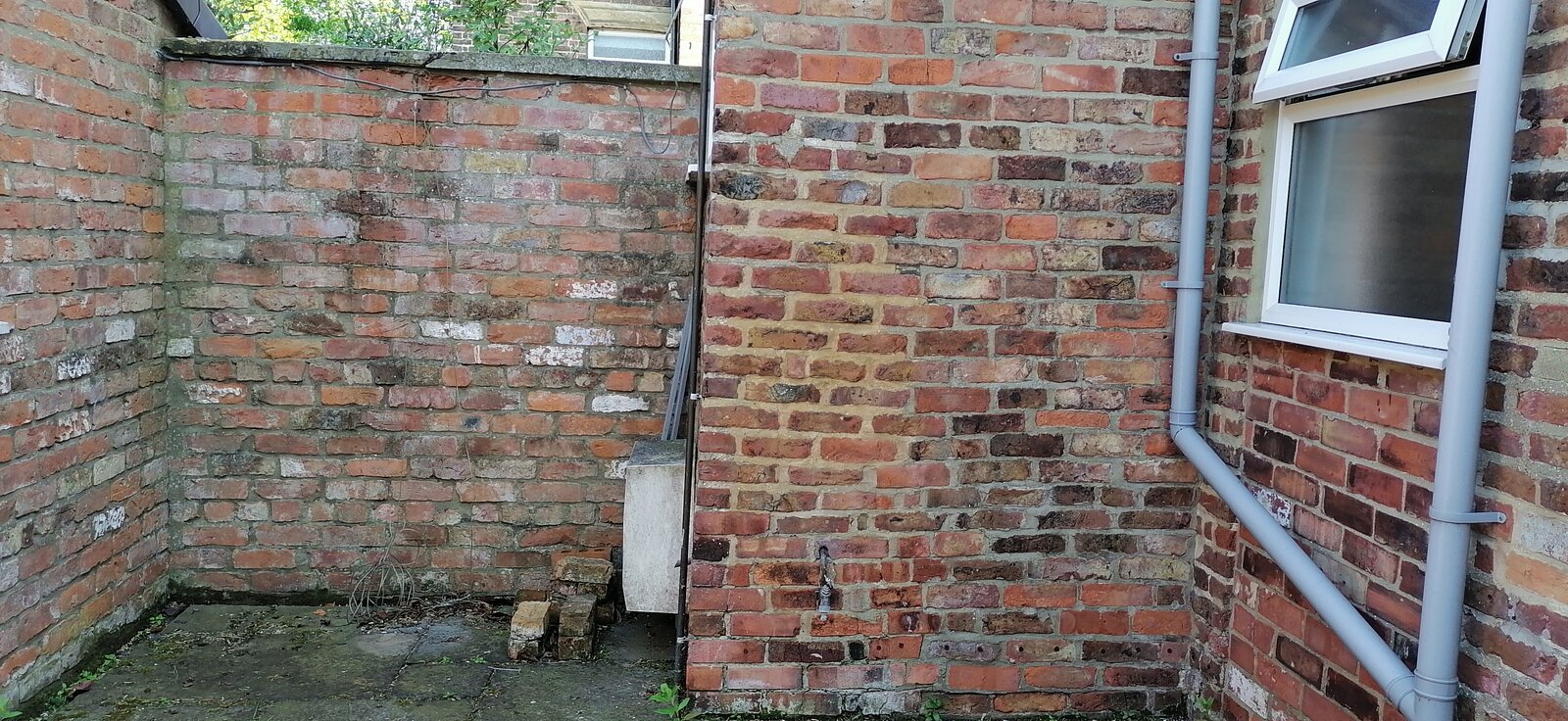

by the way.. check out this pic.. can you see that dangling cable? it feeds the garage from the main house.
Is that acceptable? looks a bit amateurish to my laymans eyes
don't touch it. It will be fragile.
It' ok short term. But should be replaced in the long term, ideally with SWA or conduit
