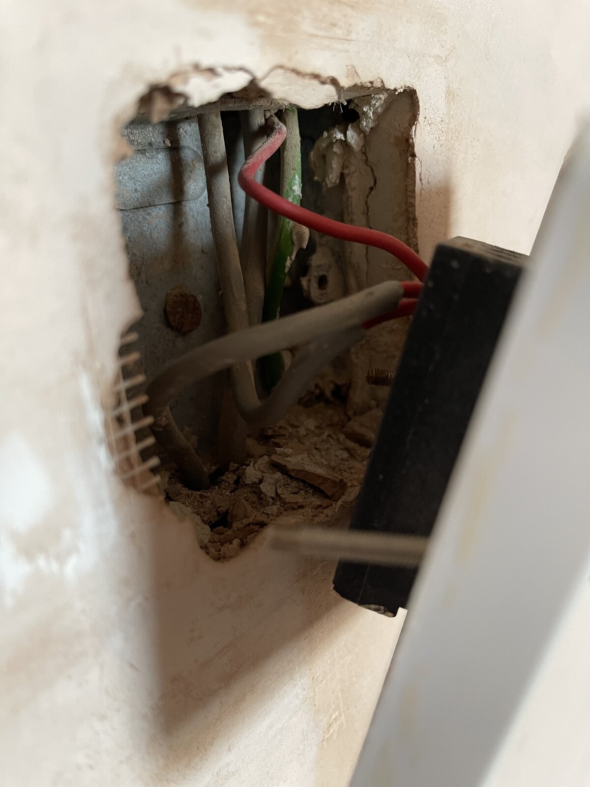

Before you go shopping, you could do with checking whether there's a neutral available at your existing dimmer switch- if there isn't this limits the devices you can use.
I'd suggest having a look for somewhere supplying led lamps and dimmers in the same shop, ideally in one box.
Wickes do dimmier switched and light bulbs. Ill open my current dimmer up and hopefully there is a neutral wire in there. It should be in there!
I opened my current dimmer. It looks like it has a neutral
what makes you think that?
are you assuming by the colour of the insulation?
No. Not at all. I studied an electrical course for 1 year mate! The colour doesn’t have to always represent it
Looking at picture I would say no neutral. I have tried using electronic switches, not dimmers, and I have found a problem with shimmer when on, the bulb and switch don't match and some interaction between the two. So ended up swapping bulbs lamp to lamp to stop it.
